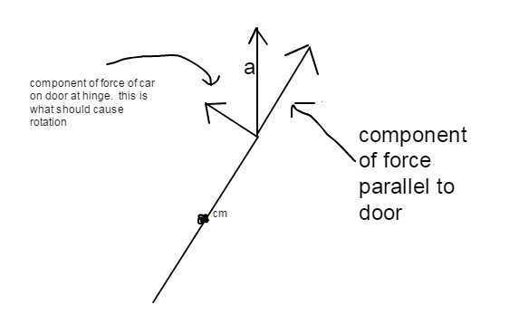

i don't know where to apply the torque. because the car is applying a force at the hinge i tried getting the tangential component there and used the the center of mass as the pivot point. but i can't find a force that makes the center of mass want to go to the right towards the car.

Don't assume that the direction of the force on the door from the hinge is parallel to the acceleration of the car.
As haruspex pointed out, the problem is easier when analyzed in the frame of reference of the accelerating car. A uniformly accelerated frame acts like a non-accelerated frame with an added gravitational field in the direction opposite the acceleration of the frame.
But if you are not familiar with this idea, then you can stick with the frame of reference of the earth.
because the force of the car is on the hinge I'm breaking the force into a component normal to the door and one parallel to the door.
OK, good. Can you see what causes the CM of the door to move to the right?
