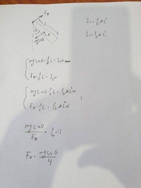

i think i understood what you meant and tried to get the relation in this photo
Handwritten physics working on paper: a rod with a force F_N at one end and a weight mg sin θ at the centre of mass, with moment of inertia I = (1/12)mL² and I = (1/3)mL², torque equations, and the result F_N = mg sin θ / 4.
thanks man,please if you can still help me to fully understand it, because i don't understand why there has to be 2 forces .
can i treat it as a normal force that opposite the wiegh components?
and because there is a torque in the tangential axis , i can't calculate the forces only with Newtons second law?
mgsin(theta)-Fn(tangential)=ma(tangential)
or this is another way

It's not that there are two forces. The reaction from the pivot is one force, but you can opt to resolve it into two perpendicular forces in any way you choose.
If you resolve it into one component along the rod and one normal to it then both are nonzero.
That's correct, if by Fn(tangential) you mean the component normal to the rod of the reaction force at the pivot.
