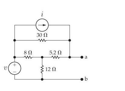

Find the thevenin equivalent of the cicuit shown below with V=500 V and i=10 A
Voc=Vth
Isc=VN
[/B]
So, to solve this, I used my instructors method of first finding the Rth. So, what I did was set the independent sources to 0(based on the fact that Rsource doesn't change based on Vth), and tried to solve for the resistance. I used the y-Δ transformation on the three at the bottom and got my Rsource. However, I am confused as to if this is right or if I am allowed to do that. I got Rsource to be 74.2 ohms, and that doesn't look correct, so I can't really move from there.
Hi roinujo1,
You're right, your result doesn't look correct. You'll have to show the details of your work if we're to spot what went wrong. I will mention, though, that if the sources are suppressed the 8 Ω resistor becomes parallel to the 12 Ω resistor, so the "Y" disappears. You might want to spend a bit more time redrawing and simplifying the circuit before bringing out the Y-Δ machinery :smile:.

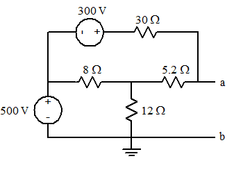

Your result of 7.5 Ω for the Thevenin resistance looks good. But I'm having my doubts about your simplification in the latest diagram. In particular, the reduction of the three resistors to the 10 Ω value looks dubious, as the current source and 30 Ω resistor are connected to related nodes.
Here's a trick you can try. Convert the current source and its 30 Ω resistor to their Thevenin equivalent. Then note that the "new" voltage source sits atop the 500 V voltage source which gives it a fixed potential of 500 V above the reference node b. It's perfectly legal to duplicate the 500 V source and move the connection of the new Thevenin model away from that node, provided that the new 500 V source is connected to node b as well. Like this:
Convert current source to voltage source, then:
Now you can proceed to simplify this new layout.

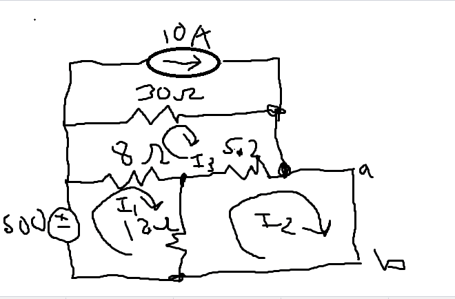

Thanks for the response again! I really wish I could use this technique, I don't understand it enough and chicked out. What I ended up doing is mesh analysis, but this time using the original 3 resistors without combining them:
And I found i1=69.97 A,i2=56.67 A, and i3=26.67 A
i2=ishort circuit
I then used ohms law to get the Vth=Rth*ishort circuit which i got to =425.03 V approximately.

That looks good.

The procedure for finding the Thevenin resistance involves suppressing the fixed sources. For voltage sources that means replacing them with a short circuit (basically a wire), and for current source, replacing them with an open circuit (removing them). In this problem, suppressing the voltage source places the 8 and 12 Ohm resistors in parallel.
The circuit with the sources suppressed:
