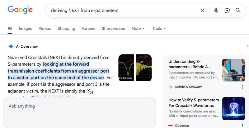

I did a Google search on deriving NEXT from s-parameters and got some good hits (videos and articles). Maybe try that same search to see if you find some useful resources...
Screenshot of a Google search for "deriving NEXT from s-parameters" showing an AI Overview with a small plot of a dip-shaped curve and a yellow waveform labelled S31, beside a list of related article results.
Hello , I did google too before posting they dont show exact matematical manual to derive it.
Is there some recoomended manual I could use?
