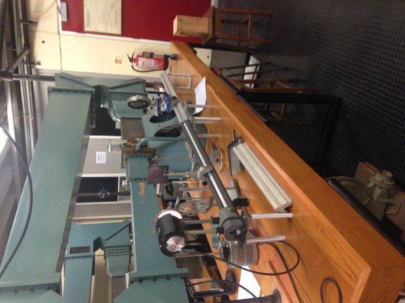

My final year project at university is to visualise the test section of a supersonic wind tunnel by schlieren method, though I'm having a bit of trouble setting it up.

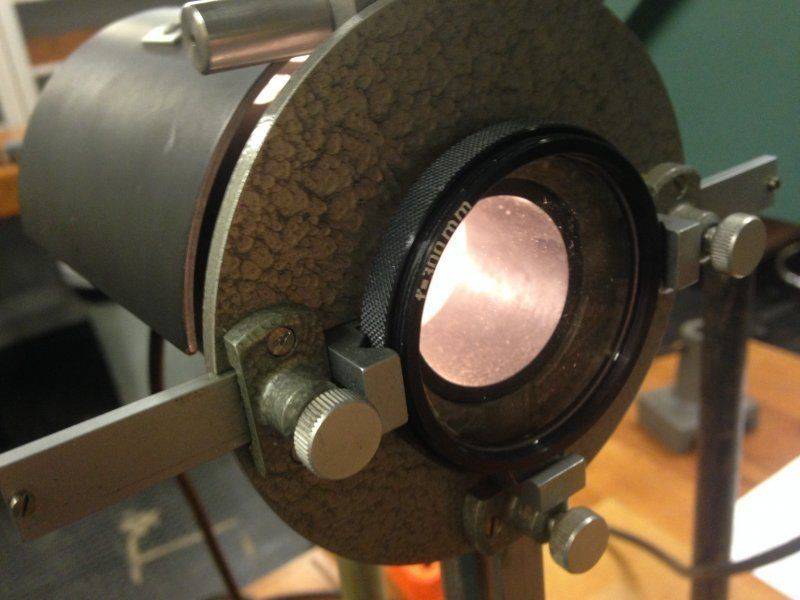

The light source I am using is a halogen bulb, in an old lamp housing, with a condenser on the end with a focal length of 300mm

According to sources I have been using, a pin hole should be used to make it a point source the distance of the focal length away

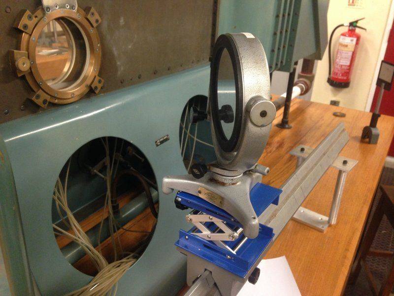

The light rays will then be reflected off a spherical mirror, the focal length of the mirror away (930mm) through the test section and onto a spherical mirror on the other side.

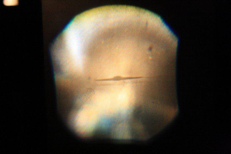

I've struggled to get the whole thing going, I put the light source, pin hole and mirror the appropriate distances away, but the light image I'm getting on the other side of the pin hole is rubbish.
Any thoughts?

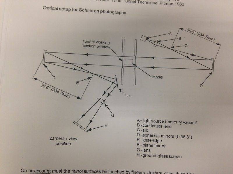

This is the set up I'm going for

I have never done Schlieren optics, but it is something that I am interested in. I have done mostly experiments with lasers over my research career, which has involved a lot of finicky optical setups.
It seems like the simpler set up that is shown in the materials at Harvard might be easier to implement. The images in the YouTube video above are pretty good, I thought. Unless you are measuring much smaller effects in the wind tunnel which require the longer path length in your setup, you might consider simplifying.
There are a lot of mirrors in your scheme, and the optical path length is very long, so alignment will be difficult. You are also using some things in your path that are going to be problematical -- not so stable (the lab jack) which may make your life miserable. With the setup shown in the Harvard demo, there are relatively fewer optical components, with less to go wrong. The Schlieren effect is obtained from tiny changes in refractive index (wiggling of the light beam) in the observation window. What happens if your optics are not stable? Your beam will have additional sources of wiggle. Your "pin hole" looks pretty ragged and is also quite large.

Hello Harry, How are you getting on?...I think you would be better off with a brighter light source and a smaller pinhole . Have you tried White LED's? You will also need to get the room really dark. I don't know the power of your halogen bulb or your pinhole size.
This looks very similar to the way I do a Foucault test on my telescope mirrors to test for sphericity... In fact I've played in the garage imaging the heat rising from a teacup using my latest 12 inch f= 70 inch mirror in the same way shown in the video with the hairdryer. However there's only one parabolic mirror with the light source at centre of curvature, not focus. A good quality single LED flashlight is best... the brighter the better with a piece of aluminum foil for a pinhole that's had a needle pushed through it. A good quality bike shop will have bright LED lights for around 20 dollars.

I managed to get it to work in the end. The main issue was I wasnt getting the light rays to converge at the pinhole (even though the pinhole was probably larger than preferable). Then swapped the spherical mirrors for convex lenses and plain mirrors. The output wasn't brilliant but I managed to get the schlieren image so I could see the oblique shock waves in the end
