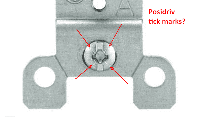

- Some participants discuss the differences between Phillips and Pozidriv screw heads, noting that Pozidriv is designed to prevent the driver from slipping out, unlike Phillips.
- There is uncertainty about whether a Pozidriv screwdriver fits ECX screws, with participants expressing difficulty finding compatible bits.
- One participant mentions the proprietary nature of ECX bits, suggesting they may not be readily available in local stores.
- Concerns are raised about the convenience and availability of various screwdriver bits, particularly for common tasks like installing electrical outlets.
