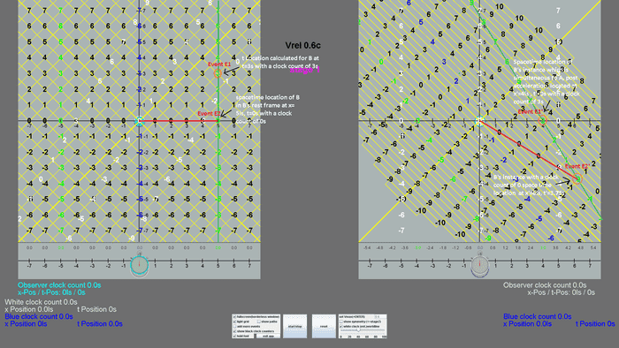

  • #33
It would help if you would start with a less complicated scenario first.
Imagine a 3rd observer C.
He observes both A and B moving towards each other with a relative speed of 0.6c. Their clocks are synced and will remain synced from in his frame of reference. When they are at a distance of 10 lightseconds, their clocks both display 0s and they release a lightbeam at the same time from C's perspective.
C draws a spacetime diagram where he places himself at x=0, t=0. A at x= -5ls, t=0 and B at x= 5ls, t=0
Observer C will measure the lightbeams to take 7.69...s to reach A and B respectively.
Since the situation is completely symmetric. A will measure the same time for his lightbeam to reach B as B will measure for his beam to reach A. They will also both measure the same distance between each other.
That is, the _instance_ of A with a clock count of 0s and the _instance_ of B with a clock count of 0s.
However, space separated events which are simultaneous in a given inertial reference frame, are NEVER simultaneous in another inertial reference frame. Observer A at x= -5ls, t=0 and a clock count of 0s is an event within C's reference frame.
Observer B at x= 5ls, t=0 is another event.
Those events are simultaneous for C.
For A, those events cannot be simultaneous, nor can they for B.
So when A checks his clock and registers 0 seconds, the instance of B he measures at a distance will not be an instance with a clock count of 0 seconds, but a higher value. Otherwise said: From A's perspective, when he registers 0 seconds on his clock, B's clock will not be a 0s but higher.
The same is true the other way around. When B registers 0s on his clock, A's clock will not be at 0s but higher for exactly the same value.You can always find an observer C which observes both A and B to be moving at the same speed relative to him. He can send a lightsignal to both A&B such that their clocks are in sync from his perspective and will remain in sync since he calculated the same time dilation for both.
Doing this, A and B will get the same results for their measurements for same clock counts on their respective clocks.
Syncing the clocks from any other inertial frame of reference in which A and B are observed to move at different speeds, would lead to different results for both. And of course, the clocks would not remain in sync either.
This is why above posters insisted on you defining the reference frame the clocks would be synced from.
If for example, A observes his clock count to be at 0s and at the same time he observes/measures B's clock count to be at 0s, B will never observe his clock count to be at 0s and A's at 0s as well, because of the difference of reference frames.
So it makes no sense for you to just say that they are in sync at 0s. They can only be in sync from A's perspective OR from B's, but not both.

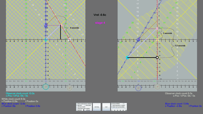

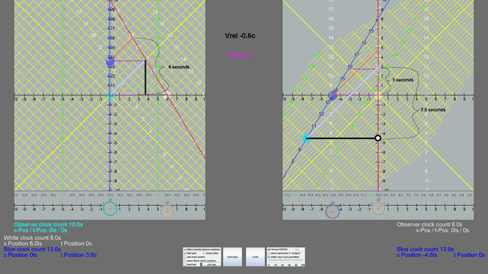

  • #44
Here is the initial post in the form of two x/t diagrams, as i would imagine you attempted to describe it, ignoring the inconsistencies with an attempt to point at what i believe you have not fully understood yet.
The magenta/light blue filled circle is Observer B. "He measures t=0" i assume to mean that he draws an x-t diagram where he places himself at x=0, t=0 and then goes on to map all other events within his reference frame onto the x-t diagram.
As you can see, observer B who in the left x-t diagram is at x=0, t=0 has a clock count of 10s currently.
He measures observer A to be at 6 lightseconds away of him, at x=6ls, t=0 with a clock count of 8s. Observer A is the white filled circle.
Observer A however, CANNOT measure the distance to the _instance_ of observer B with a clock count of 10s. As you can see from the right x-t diagram, which is A's reference frame, observer B with a clock count of 10s is not on the simultaneous axis of A.
That instance of observer B with a clock count of 10s is at about x'~ -7.5ls, t' ~ -4.5s (won't calculate the exact values), where the magenta/light blue filled circle is on the right diagram.
Instead, the instance of B which has a clock count of 13.6s(deep blue filled circle), located at the spacetime position of x'=4.8ls, t'=0 is simultaneous to the instance of A with a clock count of 8 seconds when observed from within A's reference frame.
And once again, the instance of observer B with a clock count of 13.6s, won't be able to measure the distance to observer A with a clock count of 8 seconds, because that instance of A is NOT simultaneous to this instance of B.
Instead it will be the instance of A which i marked as a pink filled circle which the instance of observer B with a clock count of 13.6s will observer as simultaneous to himself...
I hope you get the idea now.
As for the question for how many seconds it will take for the light beam to reach B when shot by A at a distance of 4.8ly, Dale already answered this correctly. 4.8 years of course, but i doubt that this was what you were trying to _really_ figure out.
That light beam in the diagrams would be the orange line. I used lightseconds instead of years because it would require too much editing.Those spacetime diagrams are taken from a screenshot of my twin paradox simulation. You might want to check it out here and download the code if you want to run it yourself (link is in the description).
maybe this will lift some of the confusion, hopefully not add to it :D

Two observers, A and B, are traveling towards each other at a relative speed of 0.6c.
In A's frame of reference, when B is 6 light-years away, A sends a photon to B.
What is the time difference in the reference frame of B between the event on the world line of B that is simultaneous with the sending of the signal in A's rest frame and the event of B receiving the signal?
Answer = 3 years ... (i hope)
What is the time difference in the reference frame of A between the sending of the signal in A's rest frame and the event on the world line of A that is simultaneous with the event of B receiving the signal?
Answer = 6 years ... (i hope)
In A's frame of reference, when B is 6 light-years away, A sends a photon to B. What is the time difference between this event and B receiving the signal in the reference frame of B?
Answer = 7.5 years ... (i hope)
And a final question:
Two observers, A and B, are traveling relative to each other at a relative speed of 0.6c.
In A's frame of reference, there is a ruler that is 4.8 light years long.
In A's frame of reference how long would it take a photon of light to travel the length of the ruler?
Answer = 4.8 years ... ( I hope)
In B's frame of reference there is a ruler. Said ruler measures 4.8 light long in A frame's of reference. How long would it take a photon to travel the length of the ruler in B's frame of reference?
Answer = 6 years ... (i hope... still feeling shaky)
  • #59
Yes.
3.75 years (##\gamma## times your last answer).
Yes.
  • #60
Ibix said:
Yes.
Yes.
Make sense. Thanks.
