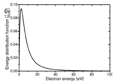

It seems like you're saying with a 10 kV e- beam it will eject electrons in the range 0-10kV (minus binding energy which is only tens to hundreds of eV). It is clear that the SED design is optimized for picking up only the ones <50 eV which could only have come from near the surface because otherwise they would be captured.
However, does that explain this entire figure? (I just pulled this one that has a typical shape I've seen in other figures.)
2025-02-28 09_52_13-(PDF) A particle-in-cell plus Monte Carlo study of plasma-induced damage o...png
http://dx.doi.org/10.1063/1.2829783
That you get this spike at low energy just because you're going to get so many more of those out of the sample, not that the actual SE generated are all mainly 0-10 eV?

Your questions are not clear.
Captured by what, the sample or the detector?
Entire has a different meaning to you than to me. You need to specify entirely, the features you need explained.
The spike is the most probable SE energy detected.
The detector does not detect very low energy SE, hence the spike.
