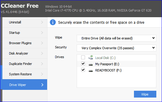

CCleaner has a Drive Wiper tool.
So does the Paragon Hard Disk Suite.
I seem to remember several freeware tools that do the same thing.
I don't believe CCleaner can erase your Local Disk, though...?
It won't on my computer, anyway...

Then get a Linux stick and use the BADBLOCKS program in destructive mode.
Better to have some cooling for the drive, because it'll get some heat...
No Windows program can erase the boot drive since the code it needs to run is on that drive.
:check:... Those were my thoughts too.
