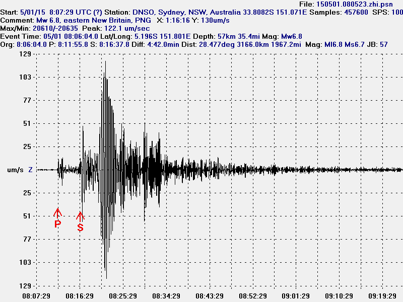

initial listing is a M 7.1 eastern New Britain, PNG
this is following the M 6.8 that occurred at that location yesterday
the 6.8 can be seen near the top of the seismogram and the 7.1 at the bottom
http://www.sydneystormcity.com/seismograms.htmDave
OK the amplitude isn't as large or as sustained as yesterday's event and the ~ 6km difference in depth wouldn't account for the difference in amplitude between the two events
I'm expecting the magnitude the probably be revised down to around 6.8 +- 0.2
Dave

OK here's the seismogram for last nite's event
and as suspected it was downgraded from the initial M 7.1 to a M 6.8
