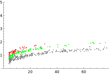

The ultimate goal is to classify a list of lists into groups, based on say the value of column 2. Then I'd like to ListPlot column 1 versus column 4 from each group, each with its own color.
I have done this manually for three groups:
Code:
ListPlot[{
    {#[[1]], #[[4]]} & /@    Select[mxs1, #[[2]] > 0.40 &&  #[[2]] < 0.42 &],
    {#[[1]], #[[4]]} & /@    Select[mxs1, #[[2]] > 0.45 &&  #[[2]] < 0.47 &],
    {#[[1]], #[[4]]} & /@    Select[mxs1, #[[2]] > 0.50 &&  #[[2]] < 0.52 &]
        }, PlotRange -> {0, 5}, ImageSize -> 300,
 PlotStyle -> {Red, Green, Gray}]
Scatter plot with y-axis from 0 to 5 and x-axis ticks at 20, 40 and 60; red, green and gray points rise steeply at small x then level off, with gray points forming the lowest band.
How can I do this for N groups by iterating through a selection parameter, say {0.4, 0.45, 0.5} in the above example?
