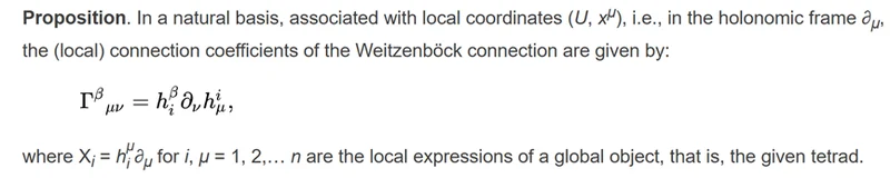

  • #61
PeterDonis said:
@ergospherical's calculation in post #10 doesn't make that assumption. Indeed, I don't think that assumption is even consistent with his calculation. So your apparent belief that you are just reversing his calculation appears to be wrong.
The difference between me and ergospherical is that he didn't demand the basis field is a coordinate basis, so they assert that there exist some extra terms between a teleparallel connection and Levi-Civita connection. and I demand that the basis should be coordinate basis field, then a teleparallel connection equals a Levi-Civita connection.

  • #67
Jianbing_Shao said:
why you don't think that assumption is even consistent with his calculation?
Because the orthonormal tetrad fields ##e_a## that appear in his calculation don't commute in any spacetime other than flat Minkowski spacetime, which means they can't form a coordinate basis. You can see this in the example he gave for the 2-sphere; the two vector fields of the basis he gave don't commute.
  • #68
In the original definition of teleparalle connection, ##e_a## should be a holonomic frame(coordinate basis field), It is not necessarily to be orthonormal.
If you demand ##e_a## is orthonormal, and at the same time it is changing, then the basis field is obviously a non-coordinate basis field, It just can prove that in ergospherical's derivation ##e_a## is not orthonormal.
It seemed that you didn't believe a metric field can be compatible with a zero-curvature connection. so you think ##e_a## only can be orthonormal, but if ##e_a## is only a holonomic frame. can we find any problems in ergospherical's derivation? If we can't, then how to explain the result?
