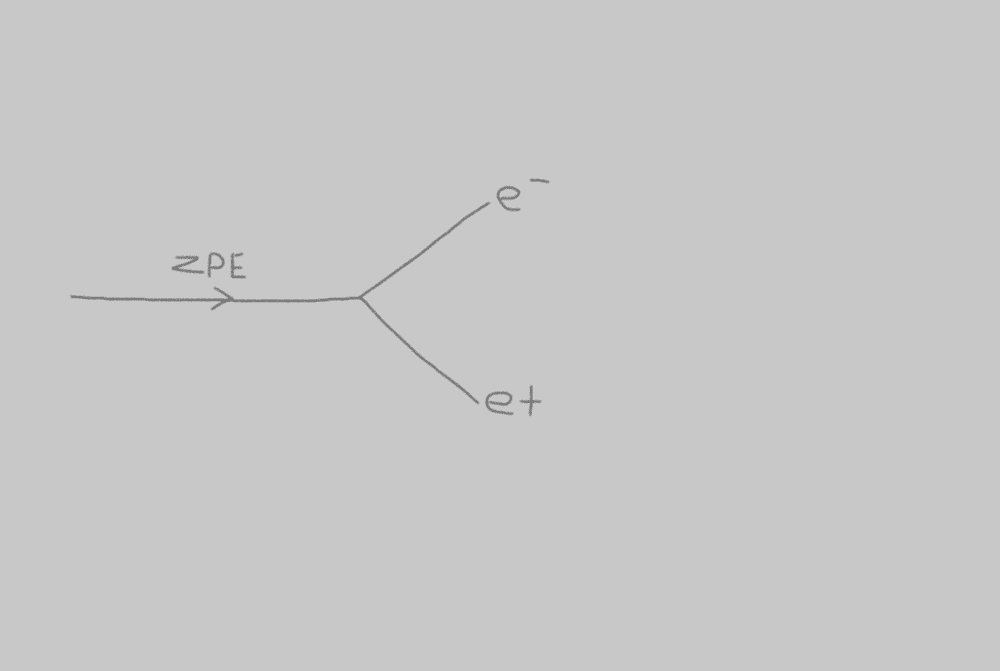

So is it not possible to "create" real particles from zero point energy?
Isn't this diagram possible?
No. There is no such thing as a "ZPE" line in any Feynman diagram. And, as has already been said, the whole idea of "virtual particles" is limited in any case and cannot be applied the way you are trying to apply it.
And, to be pedantic, even if there were, there wouldn't be an arrow on it.
