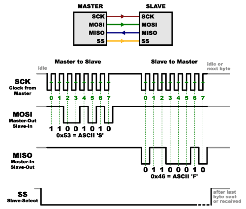

I have a SPI with a master and a slave:
How the system knows what's the starting point of the data sent ? It's ok that we have the clock, but both MOSI and MISO have a default state on "1", that may be sampled as data sent

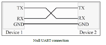

Thanks. When i studied the UART protocol i read that it need a common ground:
In the SPI diagram it doesn't appear. Why ? Probably i don't clearly understand what a commond groud is... :(
It is just implicit. They didn't bother to put it in the diagram, but it's there.
