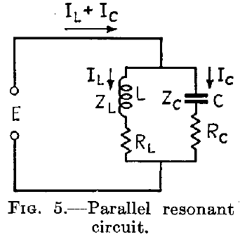

Terman wrote that early in the 1940s and employed at the time a different definition of the RLC circuits.
For the series RLC circuit, the R component was made from the sum of the L and C series resistances.
Termans series circuit was symbolically ( RL + RC ) + jXL + jXC;
For the parallel circuit, the R components remained in series with both the L and C components, before the subcircuits were placed in parallel.
Termans parallel circuit was symbolically ( RL + jXL ) // ( RC + jXC )
That explains why Terman wrote; “Furthermore, the details of the behavior of a low Q parallel circuit also depend upon the division of resistance between the inductive and capacitive branches, upon the way in which the resistance varies with frequency, and upon whether the adjustment to resonance is made by varying the frequency, inductance, or capacity.”
The convention now is to assume ideal components with a single R in series or in parallel with ideal L and C components.
