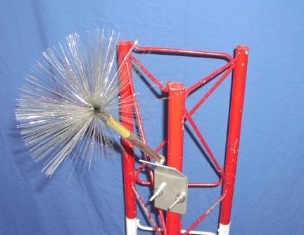

I use something called a static dissipator with lots of sharp pointy ends.
The name suggests that it helps to dissipate the buildup of static charge. That should make lightning less likely.
But less likely does not mean impossible, my dissipator got hit by lightning.
