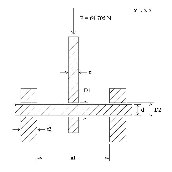

Designing a safety pin for gate valve, picture is attached! Material: EN24 (λ=680MPa and E= 207 GPa)
Total distance between supports = 98 mm! Force applied by gate is 64705 N! Question: Minimum diameter of pin for 1) No shearing , 2) a maximum deflection of 1 mm?
For circular sections: λ=(4/3)*(V/A)
Where λ= Maximum Shear(MPa) V = applied force (N) and A = Cross-sectional area of the pin (mm^2)
Normal shear at point right next to the supports is: σ = M*c/I
Where σ= Maximum Normal Shear(MPa) M = Moment created by V (N.m) c = distance from center to outside of pin:radius (mm) I = Moment of Inertia (mm^4) = ∏*r^4/8
Maximum deflection y=(V*l^3)/(48EI) Fairly well known equation...
3.The attempt at a solution
1) Safety factor = 1.5
Hence λ=(4/3)*(V/A)
But Vmax = 64705/2 = 32352.5 N because there is a counter force at other support side
680/1.5=(4/3)*(32352.5/(∏d^2/4)
giving d = 11 mm
BUT PROLBLEM σ = M*c/I gives
680 = (32352.5*49)*r/(∏*r^4/8)
giving r = 18.106 mm, d = ±36mm which I personally think is way to big! Please help clarifing this! Sorry I'm Afrikaans not the best speller!
2) y=(V*l^3)/(48EI)
y=(64705*(0.098^3)/(48*207*10^9*((∏*r^4)/8)
r = 11 mm which gives d = 22 mm
Seeing that it is a safety pin and will have to be removed I think a 1 mm deflection over 98 mm span is not unexceptable, but now I don't know whether it will shear because of the problem listed in the 1st question... Any help will be much appreciated... Thanks

WillemBouwer: Excellent work. However, I think you may have mislabeled lambda in your first paragraph. Is your steel EN24T, or what? You need to specify the heat treatment condition code, not just EN24. Is it condition T? The tensile yield strength of steel EN24T is Sty = 680 MPa. The minimum tensile ultimate strength of steel EN24T is Stu = 850 MPa. I think the minimum shear ultimate strength of steel EN24T is Ssu = 0.60*Stu = 510 MPa (?). Therefore, I think you instead should use the following criteria, where P = applied load = 64 705 N, V = shear force = 0.5*P, M = bending moment = 0.25*P*L, FSu = ultimate safety factor, and FSy = yield safety factor.
(1a) Shear rupture stress level, FSu*(4/3)(V/A)/Ssu ≤ 100 %.
(1b) Normal rupture stress level, FSu*(M*c/I)/Stu ≤ 100 %.
(1c) Normal yield stress level, FSy*(M*c/I)/Sty ≤ 100 %.
(2) Deflection criterion, [P*(L^3)/(48*E*I)]/ymax ≤ 100 %.
Also, your moment of inertia is wrong, and instead should be, I = (pi/64)*d^4. Therefore, your results for items 1 and 2 are currently wrong. Also, I think shear stress is usually called tau, not lambda, right? And sigma is normal stress (not shear stress) at midspan, not "normal shear right next to support." Try again.
Also, the pin will tend to have a center of rotation within each clevis plate clearance hole, not exactly at the inboard face of each clevis plate. Hence, your current value for beam length L is too small. Therefore, we need to know the thickness, t2, of each of the two clevis plates shown in your post 1 diagram. The two clevis plates are the two supports for your pin. You should use beam length, L = a1 + 2(pct*t2), where a1 = distance between inboard faces of clevis plates = 98 mm, t2 = clevis plate thickness, and pct = pin end center of rotation location, as a percentage of t2. For relatively thin clevis plates, you could use pct = 0.50. For relatively thick clevis plates, you might be able to use pct ≥ 0.25 (?). But we need to know, what is the thickness, t2, of each of your two clevis plates? And what is your value for FSu, and your value for FSy?

t2 = 5 mm therefor L = 98+2(0.5*5) = 103 mm
Never seen this before, didn't expected the rotation to make such a difference! Makes some sense though!
As for lambda, couldn't find the tau sign so I guessed you guys would be able to figure it out! Think it is a translation problem but yeah I meant normal stress(σ). Why I said it is at a point next to the support is that this is furthest away from the centre, rookie mistake as I checked my moment diagram and saw the max bending moment is indeed at midspan thanks!
Moment of inertia: rookie mistake again as I took the semi-circular equation from my textbook, is indeed (pi*r^4)/4 = (pi*d^4)/64
Material is indeed EN24T!
Fsu = 1.6
Fsy = 1.2
Newly calculated solutions:
1a) Fsu(4/3)(V/A)/Ssu ≤ 1
gives d ≥ 13.13 mm
1b) Fsu(M*c/I)/Stu ≤ 1
gives d ≥ 31.7 mm
1c) Fsy(M*c/I)/Sty ≤ 1
gives d ≥ 31.05 mm
2) (P*L^3/(48*E*I))/ymax ≤ 1
gives d ≥ 19.5 mm
So the minimum diameter that we can use for no rupture is 31.7 mm. Seeing that a 1mm deflection will be achieved if a 19.5 mm diameter pin is used the deflection will be much less than 1mm when the pin will rupture? We've done some practical tests with a 18mm pin and the pins tend to deflect to about 2 mm at midspan without rupture! This is why I thaught my calculation were wrong! Any thaughts on this... Just want to know if I understand correctly, is the minimum diameter pin we can use for this problem then 31.7 mm or what?

Dimensions from diagram:
a1 = 98 mm
d = 18 mm
t2 = 5 mm
t1 = 14.5 mm

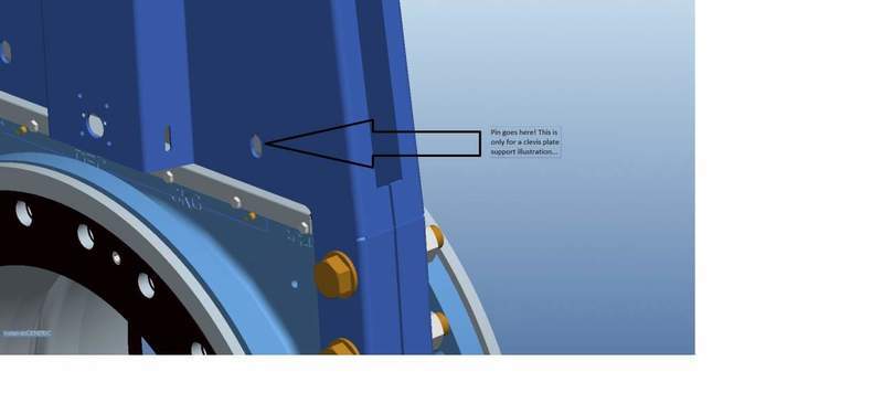

The hole is actually an upright slot like this without the strikethrough:θ (just an illustration)
The diameter of end semi circles is 20 mm and the height is 30 mm
D1 is not a dimension as the whole gate rests at the top of the pin as in the first diagram!
Clevis plates support illustration has been attached!

Are you sure the load applied to your 18 mm pin is truly P = 64 705 N?
You said your pin is entering the plastic range. Do you want to allow yielding of the 18 mm pin? Or do you want to prevent yielding?
Let me know about the above questions, and then I will review the calculation approach.

WillemBouwer: But what applied load was applied at the midspan of the 18 mm pin you tested? Was it 64 705 N? Or was it 37 700 N? Why did you say 64 705 N, earlier?
Does the gate (14.5 mm thick) have a circular edge, which presses on the pins? Or is it a flat edge? If it is a circular gate, are you sure you did the vector mechanics correctly, to obtain the force applied to each pin? If a circle (a disk) presses on the two pins, the total force on the pins will be greater than the total axial applied force. Do you have a free-body diagram (FBD) showing the system, the 400 mm actuator rod, and how the force is applied to each of the two pins?
WillemBouwer: Under static loading, the extreme fiber of your pin will begin to yield long before your pin ruptures. Because of your ultimate and yield factors of safety, and because of your pin material and ultimate plastic shape factor, bending ultimate stress does not govern for your pin. Bending yield stress governs over bending ultimate stress. You can currently ignore bending ultimate stress. Therefore, to analyze your specific pin, you only need to compute the bending yield stress level (criterion 1c in post 2).
You stated you do not want your pin to begin yielding, and you stated you want to use a yield factor of safety of FSy = 1.20. Therefore, you only need to use criterion 1c in post 2, to design your pin.
Because of the thickness of your center plate (t1), and because of your clevis plate thickness (t2), you can currently use a beam effective length of L = 95.8 mm, instead of 103 mm (because t1 slightly reduces the moment arm).
I am currently assuming your applied load is P = 37 700 N (?), until I see your responses to my questions in post 8. Therefore, using P = 37 700 N, L = 95.8 mm, and FSy = 1.20, then criterion 1c in post 2 currently gives, d = 25.32 mm. Therefore, the required pin diameter is currently 25.32 mm.
You greatly overstressed your 18 mm pin. After the test, you observed a large amount of permanent deformation. Although you did not apply enough load to cause the pin to rupture, the pin was greatly overstressed, nonetheless.

WillemBouwer: Your applied load, P, is equivalent to two loads, 0.5*P, centered on the beam, and separated by a distance 0.5*t1. Therefore, the maximum moment is M = (0.5*L2)(0.5*P) = 0.25*P*L2, where L2 = beam effective length for moment = L - 0.5*t1 = 103 - 0.5*14.5 = 95.8 mm.
However, you cannot use L2 for deflection. For deflection, you can use L = 103 mm, but then deflection will have an error of 0.73 %, due to the thickness of t1. To avoid the 0.73 % error, you can use y = P*(L3^3)/(48*E*I), where L3 = beam effective length for deflection = 102.75 mm. Therefore, if P = 37 700 N, E = 207 000 MPa, and d = 25.32 mm, then
M = 0.25*P*L2 = 0.25(37 700)(95.8) = 902 915 N*mm,
y = P*(L3^3)/(48*E*I) = (37 700)(102.75^3)/{48(207 000)[(pi/64)*25.32^4]} = 0.2040 mm.
WillemBouwer said:
I get the same answer as you, 25.32 mm, for no yielding! So this will mean that the pin will not deform plastically but only in the elastic region, and will return to its normal position after the load has been taken off?
Yes, that is correct.
