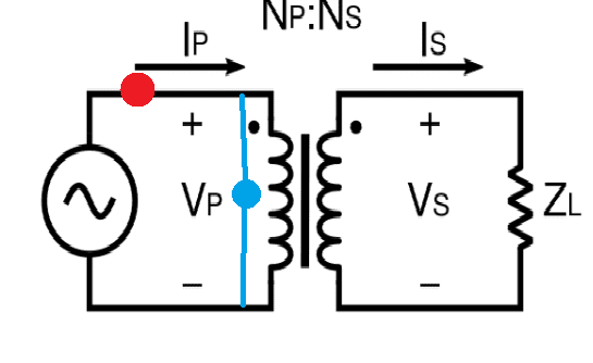

OK, try this figure. It shows an ideal transformer. I added two light bulbs. The red bulb is in series, and the blue one in parallel.
At the start current flows to the load Zl and both bulbs are lit. Now we remove the load. Is=0. The red light goes out but the blue one stays lit. Do you see it now?
I still don't see it.
So I think I get this now, the inductor will use most of the circuits voltage thus causing the red light to go out, but since the inductor is in parallel with the blue light, they will both be given the same amount of voltage, thus making the blue bulb bright. The high inductance of the inductor hurts the red bulb but helps the blue bulb.
Interestingly enough, I just built this circuit and tried it out and I didn't receive the results you described.
When I built the circuit that is shown in the video, which is the same circuit as yours without the parallel bulb in the primary, it worked as expected! When the secondary was a full loop, both the light in the primary and secondary lit. When I removed the light from the secondary, the light in the primary went out!
When I attached a bulb in parallel to the inductor as shown in your diagram it very brightly lit up both bulbs in the primary and put out the bulb in the secondary. Even when I disconnected the bulb in the secondary, the two bulbs in the primary remained brightly lit. I believe this is because the resistance of the parallel bulb was so small in comparison to that of the inductor that virtually no current was flowing through the inductor. I attached some ammeters and confirmed it!
That's wrong. With no secondary current both bulbs see half the supply voltage so will both be on at roughly half brightness.
On second thought, you're correct, thanks for pointing out my error.
My example was flawed because one of those bulbs would short the transformer primary. What I was trying to illustrate is that the voltage across the primary would be the same as supply voltage with no current. I should have shown a high impedance voltmeter across the primary rather than a second bulb.
