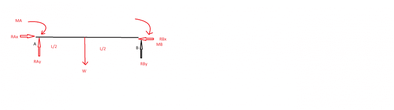

Lets say i have a structure like this , at A and B are fixed support ( it resists moment about , force in x and y direction) I want to find the moment about the A , should I include the MA as well in my calculation or no ?
moment about A = MB +MA + W(L/2) -RBy(L) = 0 ?
or moment about A = MB + W(L/2) -RBy(L) = 0 ?

Suppose this beam was a simple cantilever fixed at A but free at the other end. Same applied loading. Would you include the moment at A when summing moments about A in your moment equilibrium equation?

So, we don't have to consider MA when calculate the moment abour A?
How did you come up with that conclusion?

Oh, bad tone. Try the simple cantilever case, say a beam A-B of length L fixed at A and with a load P applied at the free end B. Now sum moments about A = 0. Does MA show up in that equation or not?

no, how is it relate to the question i asked?
In your problem, I cannot tell you whether or not to include MA in your equation when summing moments about A , because that is against forum rules . BTW, the problem is statically indeterminate. But anyway, as a hint, if you consider a simple cantilever of length L fixed at end A with the unknown moment M_A at that end and with a load P applied at the free end, then summing moments about A for equilibrium yields M_A - PL = 0. Thus M_A = PL as you would expect. The moment of any couple about any point is the couple itself. So back to your original problem about whether to include M_A in your equation...what say you now?

yes , i should include MA when i want to calculate the moment about A
