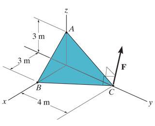

The discussion centers on calculating the moment produced by a force of 460 N acting perpendicular to an inclined plane about point A. The participants provided vectors for the position and unit vectors, ultimately computing the moment as r(CA) x F, resulting in the vector 1382i - 1767j - 2356k. However, there is confusion regarding the correctness of the calculations, as the online tool masteringengineering.com indicates the answer is incorrect. Clarification is sought on whether the magnitude of the force is indeed 460 N.
