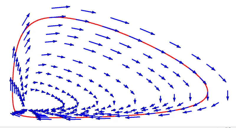

I like to think of differential equations as vector fields, e.g., the predator-prey system,
The initial conditions determine where you start your flow through such a vector field. Hence, they have the same dimensions such a starting point has in phase space.
