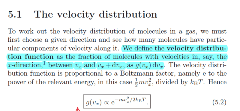

I want to ask whether there should be a constant in RHS of (5.8).
There is a ##\propto## in the previous step.
So, ##g(v_x) ~g(v_y)~g(v_z) ~dv_x ~dv_y ~dv_z ∝ e^{(\frac{-~½mv^2}{k_BT})} ~dv_x ~dv_y ~dv_z ##. Right?
Yes
Thank you for helping me.
