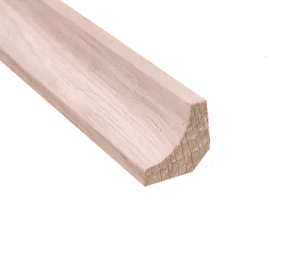

I did this several years ago.
I glued the panels to the wall (plaster).
My panels had good edges so they butt joined nicely.
I just put a small (maybe 1/2") molding over where they met in the corner:
I routed the back of the top molding so it would fit flat over the paneling but lie flat on the plaster wall.
