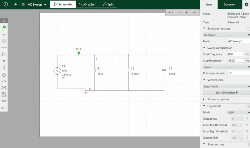

leejohnson222
76
Vs = 10 V @ 1.5 kHz, R = 15 Ω, L = 2.7 mH and C = 1.8 μF
produce a resonance curve for the circuit between 800 Hz
and 4.5 kHz.
no equations are needed
i have created the circuit but i am not sure what to do from here, this program is new to me
You have a voltage source, probably with zero internal resistance. A current will flow through the individual parallel RLC components, but there will not be resonance, because the components are short-circuited by the voltage source.
If you replaced the voltage source with a current source, LC resonance would be possible.
ok i can change the VS but what would i set the current to? and would it be Peak or RMS ?
i tried a few times and it keeps giving me errors, i dont know how to use this simulation correctly

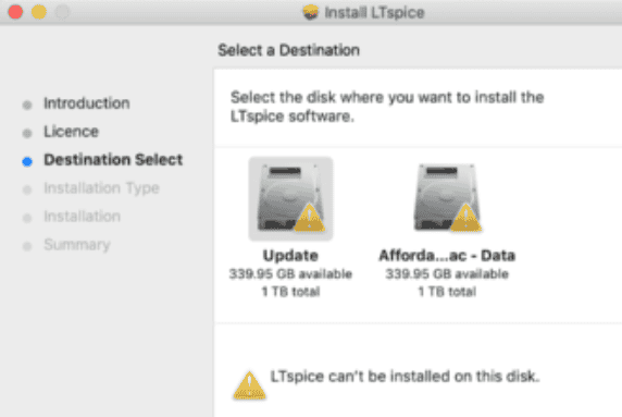

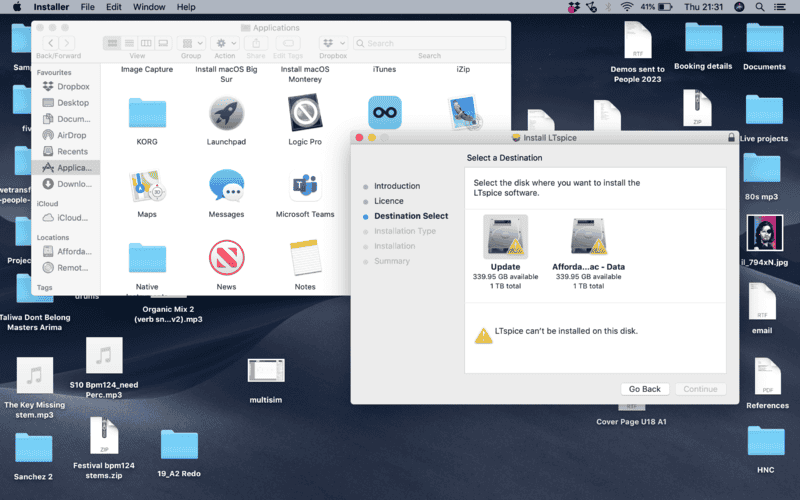

i used this one as its an online version and it works, i was recommended LTspice but my mac wouldnt install it, kept saying the HD would not allow it or something strange
It would be weird if it were a certificate error, since the install is from a large and well-known company. Can you try again and post the error you are seeing?
yeah of course, here you go, i tried the 2nd HD and it said you can only install where the OS is installed
Weird. I know nothing about Macs, but those disk names don't look valid to me. Don't you have something like a C: drive? Those look like virtual drives or something? We may need to repost this issue in the PF Computing/Software forums if it's not easy to figure out here...
i would be happy to get LT spice working to get some direct advice and help with this question.
I did have an issue with the hd a few months back and i was told the name is incorrect and i need to change it as i couldnt install the new OS, i will try that first, but i need to back up everything as it will possibly wipe my drive. Thinking about it, i have a work laptop, maybe i could install it on there

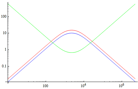

Your problem as you have stated it wants you to "produce a resonance curve". It's not asking you for a curve of any particular property of the circuit, such as a voltage appearing somewhere in the circuit.
How about a plot of the impedance vs. frequency as seen by the voltage source? Or a plot of the current vs. frequency supplied by the voltage source?

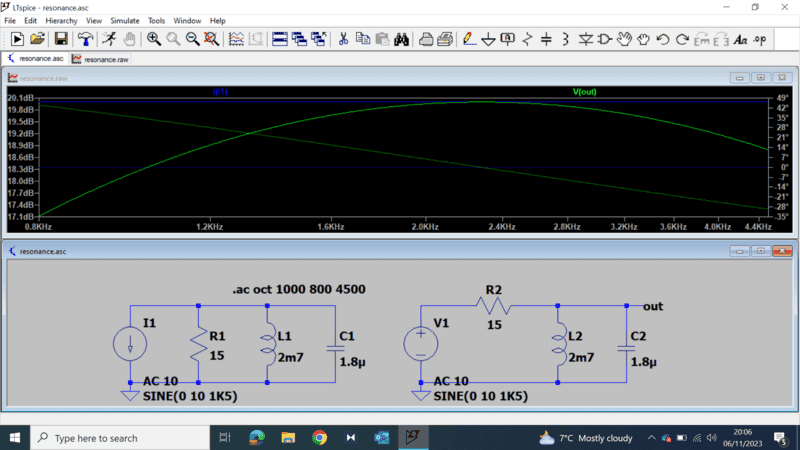

ok its installed, i managed to create the circuit, but will need some help as i have even less of a clue on how to use this program, maybe its as you said, it may not be about the actual circuit with the settings given,
maybe they just want me to create a resonance curve ??
The LTspice learning curve is steep, and the help is cryptic.
Ask questions here for help.
Here is a starter circuit to get you going.
Remove the extra .txt extension to make it into a .asc file
Click on the resonance_1.asc file to load it with LTspice.
Run it.
Click with mouse on the 'out' label to plot out voltage and phase; V(out).
Hover mouse over L1, click to get a plot of L1 current and phase; I(L1)
Change the resistor values and try again.

great so i have it working now, right i see the resonance, so basically there are 2 parts being looked here, is this current and voltage across the frequency and magnitude scale
This is the homework forum, so we should not do the work for you.
One circuit is excited by 1 amp, the other is excited by 1 volt.
Voltage sources have zero output resistance, so the LC circuit is driven through R.
Current sources have infinite output resistance, so the RLC circuit has R in parallel.
You have the simulator working now, so you can change the component values and look at different currents, voltages, and differential voltages.
To edit things, right-click on values or command text.
Change the L and C values to change the resonant frequency.
R sets the Q of the circuit, try different values.
Be productive, play LTspice simulation of circuits, not video games.

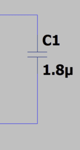

ok i see what your saying this is very helpful, especially as i was already struggling with multisim, Ltspice is another program with different ways of doing things, so it is very helpful to me, as you say i will play with this and see what i can learn from it. One more question i noticed the way the C value is 1pico8 is this how you input different values with the SI unit in the middle
it shows up on both capacitors and the inductors, with the SI in the middle like 1K5 i assumed it was 1.5K ?
On schematics, the decimal point is replaced with the SI multiplier, so 1.8uH becomes 1u8, 1.8u would also work.
NEVER enter the unit H or F as part of the value.
Only the first alpha character is significant.
A 1F5 capacitor is 1.5 femtofarad, not 1.5 farad.
1.5 picofarad is 1p5
1.5 milliohm is 1m5
