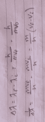

Show that for a nonrelativistic particle, a small change in speed leads to a change in de Broglie wavelength given from
I have tried to expand the left hand side of the equation, but found that it gave the answer of v0/delta v. My definition of delta lambda is the final wavelength minus the initial wavelength.

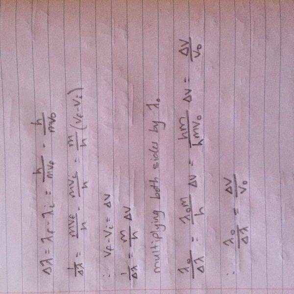

Sorry, my attempt is as follows.
In the book (Eisberg, Resnick - quantum physics of atoms, molecules, solids, nuclei and particles, pg. 82, question 10) it has the answer as that given above, however, my attachment proves that wrong. Is there anywhere I may have made a mistake?

In your first step you write something that looks like ##{1\over a -b} = {1\over a} - {1\over b}## to me o0) ...
I can't find where I have done this. How would you do this question?
What you did is equivalent to that.
You had ##\displaystyle \ \Delta\lambda=\frac{h}{mv_f}-\frac{h}{mv_i} \ .##
Then you did this:
##\displaystyle \ \frac1{\Delta\lambda}=\frac{mv_f}{h}-\frac{mv_i}{h} \ .##
However, ##\displaystyle \ \frac1{\displaystyle\frac{h}{mv_f}-\frac{h}{mv_i}}\ne\frac{mv_f}{h}-\frac{mv_i}{h} \ .##

Okay, I understand that! I was able to try and attempt to solve this with the new knowledge, however I got stuck. I derive an answer that is
##\displaystyle \ \frac{\Delta \lambda}{\lambda_0}=\frac{-\Delta v}{v_f}##
If my mathematics is correct, that would mean that
##\displaystyle \ \frac{-\Delta v}{v_f}=\frac{\Delta v}{v_0}##
But I can't think of any relations that would make the above true?
##\displaystyle \ \frac{\Delta \lambda}{\lambda_0}=\frac{-\Delta v}{v_f}\ \ ## is correct. The book means to say ##
\displaystyle \ \frac{\Delta \lambda}{\lambda}=\frac{|\Delta v|}{v}\ \ ## but finds the sign so trivial that it leaves out the ##|\ |##.
And for a small change ##v = v_0 \approx v_f## in the denominator -- NOT, of course in the difference.
This reminds me of differentiation and error propagation:
With ##y = 1/x## you have ##dy = -1/x^2 \; dx## so ##dy/y = -dx/x ## !
mindblow moment. Thankyou for your help!
