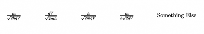

A particle of mass m and charge q is accelerated across a potential dierence V to a non-relativistic velocity. What is the de Broglie wavelength of this particle?
Is it
I think it's
## \frac{h}{\sqrt{2mqV}} ##, because ## qV = \frac{p^2}{2m}## , or : P.E (at rest) = K.E (after acceleration), so that ## p= \sqrt{2mqV}, \lambda= \frac{h}{p}= \frac{h}{\sqrt{2mqV}}##
You can boost your confidence by using the fact that the provided options all have different units.
## (\frac{h}{\sqrt{2mqV}} )^2 : \frac{J^2 . s^2}{kg.C.volt} = \frac{kg^2 . m^4}{s^2} \times \frac{A . s^3}{kg. C. Kg. m^2} ##
## = m^2 \times \frac{C/s. s}{C} = m^2 ##
Well then you have found the answer.
Thanks :)
