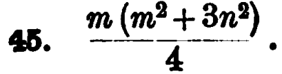

If ##x+y=m## and ##x-y=n##, express ##\boldsymbol{x^3+y^3}## in terms of ##\boldsymbol m## and ##\boldsymbol n##.
We have ##a^3+b^3=(a+b)(a^2-ab+b^2)##
Let me start by showing the problem as it appeared in the text.
Attempt :
##{\color{red}{\large *}}## The key thing is to do the problem in a "good way", whereby I can express ##x^3+y^3=f\{(x+y), (x-y)\}## purely, with no cross terms - and that is not what I am able to do.
Below I reproduce what I could do, both methods less than satisfactory.
Method 1 (bad - brute force) : Given ##x+y=m## and ##x-y=n##, we solve them to yield ##x=\dfrac{m+n}{2}, y = \dfrac{m-n}{2}##.
The required expression ##x^3+y^3=\dfrac{1}{8}\{(m+n)^3+(m-n)^3\}=\dfrac{1}{8}(2m^3+6mn^2)=\boxed{
\dfrac{m}{4}(m^2+3n^2)}\quad{\color{green}{\Large{\checkmark}}}##, agreeing with the answer in the text shown alongside.
Method 2 (partly satisfactory) : Let's write ##\small{x^3+y^3 = (x+y)(x^2-xy+y^2)=(x+y)\{(x-y)^2+xy\}=m\left\{n^2+\dfrac{1}{4}(m^2-n^2)\right\}=\dfrac{m}{4}(4n^2+m^2-n^2)=\boxed{\dfrac{m}{4}(m^2+3n^2}}\quad{\color{green}{\Large{\checkmark}}}##
Request : Is there a neater way to solve it, as I mentioned above alongside the ##{\color{red}{\large *}}## ?

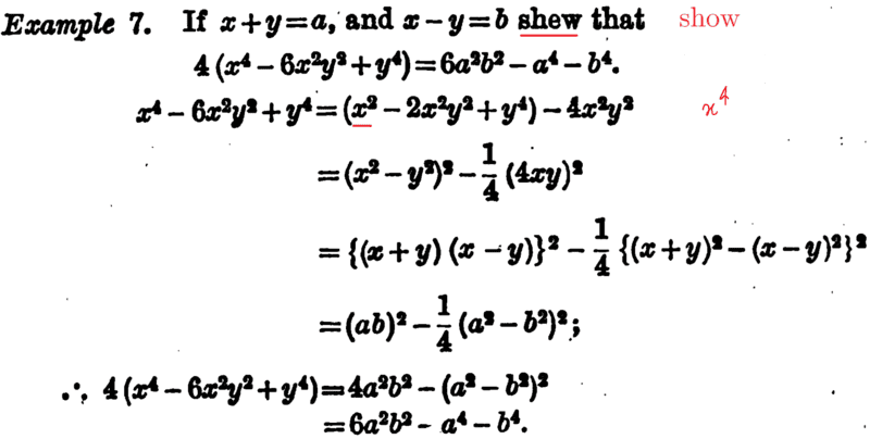

Yes there's an element of intelligence about the method. Nonetheless, asked some different and more complicated expression of the form of ##f(x,y)=?,## we can proceed with ##\small{x+y=m, x-y=n\Rightarrow x=\dfrac{m+n}{2}, y=\dfrac{m-n}{2}}## and plug in the variables ##m,n## to replace ##x,y##. If you tried it that way, the "brute force" character of the situation would become apparent to you.
On the other hand, the book I am following [Hall and Knights Elementary Algebra (1888)], the authors suggest a nicer way - express the function ##f(x,y)=g\{ (x+y), (x-y)\}##, via algebra, where ##g## will be (obviously) a different function. If you do that, the result is straightforward ##-## just replace ##x+y=m, x-y=n## wherever you find them in ##g##.
I copy and paste an example from the text. [By the way, the word should be show in the text below and not "shew". "Shew" being repeated throughout the text, I think this is how they spoke and wrote English in old England. Also note the error in the 2nd line of the solution ##-## it should read ##x^4## and not ##x^2##.]
I think the binomial method is quite general and easy to remember:
$$x^2 + y^2 = \frac 1 2(a^2 + b^2)$$$$x^4 + y^4 = \frac 1 8(a^4 + 6a^2b^2 + b^4)$$$$xy = \frac 1 4(a^2 - b^2)$$$$x^2y^2 = \frac 1 {16}(a^4 -2a^2b^2 + b^4)$$Then, we have:
$$4(x^4 - 6x^2y^2 +y^4) = 4(x^4 +y^4) -24x^2y^2$$$$ = \frac 1 2(a^4 + 6a^2b^2 + b^4) - \frac 3 2(a^4 -2a^2b^2 + b^4)$$$$=6a^2b^2 - a^4 - b^4$$
