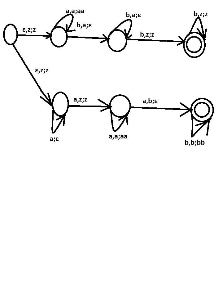

I like Serena said:
Oh wait!
The PDA correctly accepts $a^nb^nb^+$ in the upper branch.
However, in the lower branch it accepts $b^na^na^+$... that is not right. :eek:
It should accept $a^+a^nb^n$.
I have changed it :) Is it right now?
Let me take a more careful look this time. :o
In the upper branch we can read $\varepsilon$ and leave the stack as $z$.
Then, in the next state, we can read $a$, but only if there is an $a$ on the top of the stack... but the first time there is a $z$ on top, so we're stuck! :eek:
In the lower branch we can now read $a^+$, leaving a $z$ on top of the stack, which is good.
Then we're stuck again, because we can't move on as long as the $z$ is still on top of the stack.
When we're able to pass that blockage, there is one more hurdle.
We will have a stack full of $a$'s... and we can only move on if there is a $b$ on top of the stack, but they were never pushed onto the stack! :eek:

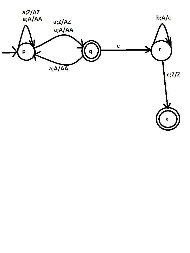

I tried to make a deterministic pushdown automaton for $a^{n+m}b^n$ with $m>0$ .Could you tell me if it is right? :o
  • #42
I'm afraid it's not.
- It is not deterministic, since reading an $a$ can both lead to a state shift from $p$ to $p$, as well as a shift from $p$ to $q$.
- It allows to read exactly as many $b$ as it has read $a$, meaning it does not fit the language.
