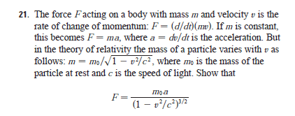

Am I supposed to take dm/dv? That means m0 is constant, correct?
If I do that I end up getting a m' on the Left hand side... What the heck does that mean?! Also where the crap is the "a" coming from?!
Consider: F = d/dt (p) = m dv/dt + v dm/dt = m a + v dm/dt
Now introduce your idea of taking dm/dv in coming up with dm/dt as a function of a and dm/dv.
Warning: I have not succeeded myself in deriving this result. And I know it's correct, dadblame it!
Somebdy - help!

a = dv/dt.
Correct.
Since there is no [itex]m'[/itex] in the problem, the [itex]m'[/itex] means whatever you said it meant when you wrote it down.
Read the problem again.
Somebdy - help!
It does work.
tms said:
It does work.
Yeah, I know it has to, I just could not get the result.
I think the problem should have stated that the force is assumed to act parallel to the velocity. Perhaps that was meant to be evident by the lack of vector notation. But, anyway, it's worth noting that if the force does not act parallel to the velocity, then you will get a different result for the relationship between the force and acceleration. (In fact, the acceleration is generally not even in the same direction as the force).
I'm still not getting it right. There must be something I'm missing.
The constants are m0 and c, correct?
when I do d/dv I end up with [ -2m0vc^(-2) ] / (1-(v^2/c^2))^3/2
F=d(mv)/dt.
dm/dt=dm/dv dv/dt = a dm/dv .
Your formula for dm/dv is not correct. The first "2" should be 1/2.
