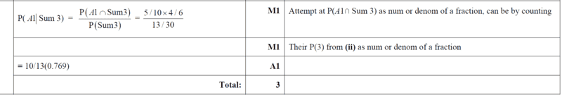

Part iii. of the question.
Given that ##x=3##, find the probability that the card chosen from Pack A is a ##1##.
In the markscheme (well understood), they used Conditional probability i.e
Alternatively, from my table above;
We have ##P(x=3)=\dfrac {26}{60}## and the Probability ##P(A1∩sum 3)= \dfrac {20}{60}##
therefore;
The probability that the card chosen from Pack A is a ##1=\dfrac {20}{60}×\dfrac {60}{26}=\dfrac {20}{26}=\dfrac {10}{13}##
Your answer seems fine to me, the mark scheme says getting the probabilities by counting is fine.
