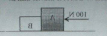

A person pushes on two boxes with a horizontal force 100N force on a frictionless floor, as shown below. Box A is heavier than B.
(its flipped ard yeahhhh the picture)
Which of the following is correct?
A: Box A pushes on Box B with a force of 100N, and Box B pushes on A with a force of 100N
B: Box A pushes on Box B harder than box B pushes on box A
C: Boxes A and B push on each other with equal forces of less than 100N
D: The boxes will not begin to move unless the total weight of the two boxes is less than 100N

2) Why do the boxes push on each other with equal forces of less than 100N? where has the other remaining force went to... why isn't it 100N push on A which push on B which push back on A.
you need to do F = ma on A, and on A-and-B …
what do you get? :wink:
