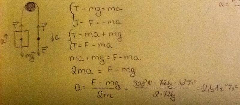

To hoist himself into a tree, a 72 kg ties one end of a nylon rope around his waist and throws the other end over a branch of the tree. He then pulls downward on the free end of the rope with a force of 358 N . Neglect amy friction between the rope and the branch, and determine the man's upward acceleration.
Newton's laws of motion.
Handwritten physics working: a pulley-and-rope sketch with a box labelled a and mg, forces T and F marked, followed by equations for T and a, ending with a = (F - mg)/2m = (358 N - 72 kg * 9.8 m/s^2)/(2 * 72 kg).
The answer must be a =0.14m/s2[/B]
How do you get from -2.414m/s2 (handwritten) to 0.14m/s2 (your answer)?
Suppose I changed the problem to: What force must he pull with in order to stay in place (a=0)?

I know, but the book gives the answer that a = 0.14 m/s2 . Are you sure it's a mistake?
I believe that because there is a pulley, the question isn't as simple as "he weighs more than the force he exerts so therefore he must not be lifted"; have you learned about the physics of pulleys? I think that is the area of physics this question might be about...
We're dealing with a fixed pulley, so it doesn't change anything.
I thought the lifting force required is still reduced
What about Newton's 'equal and opposite law'? When the man pulls down on the rope, does the rope not pull back up on him?
Yes - but I think the problem lies in the fact that when the man pulls down on the other rope, he does so by transferring some of his "weight" to the other rope. From where else would he get any force?
You can say it like that if you'd like, but that's saying exactly the same thing. The man pulls down on the rope and the rope pulls up on the man. The rope supports part of the weight of the man, and the weight of the man supported by the rope pulls down on the rope. Etc.
The reason I mention this is because the OP did not include it in his free body diagram.To the OP:
kaspis245 said:
That's easy:
F = mg = 72 kg * 9.8 m/s2 = 705 N
That's incorrect. Fix your FBD, fix your equations, and try again.
Also, in your equations you wrote, "T-F=-ma" but that "m" is not the same "m" as in the equation above it, is it?
