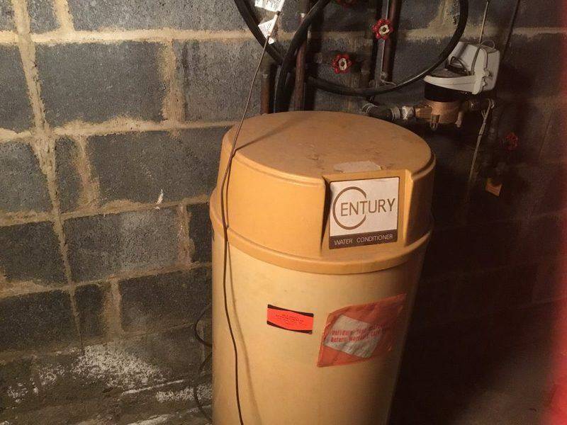

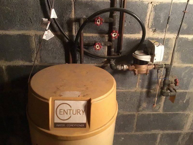

Does the tank have a thermostat on it? If so then its a hot tank or thermal store. Otherwise it could be a cold water tank.
How many pipes go in and out of the boiler/furnace? Two or three usually.

The pictures don't show a thermostat. I think it's just cold water.

You have completely flummoxed me now. That picture seems to be of a water softener. It should never get hot because it's fed with cold water.

First thank you for pointing out it is water softener. It's.

Thank again for identifying the water softener. It appears I don't have water tank at all. Hope mods will delete #14 posting soon.

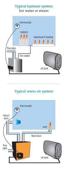

Copied and pasted below. Picture on typical hydronic system is what I have. It does not show hot water tank.
Ignore the picture next below about typical warm air system.
How your oil-fired heating system works

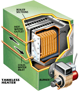

Add comments: I believe you mean heat exchanger. I guess the same as water heater. That is all I can see in basement besides water softener tank.

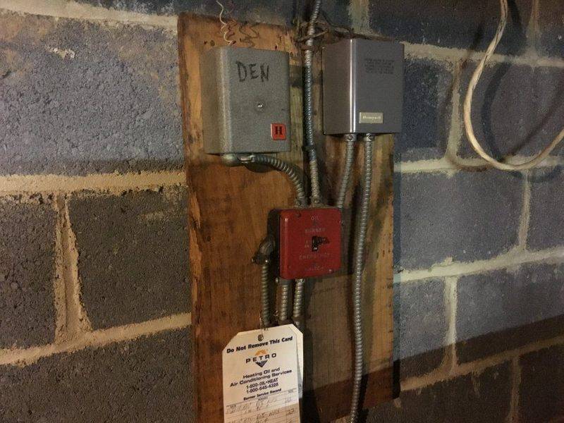

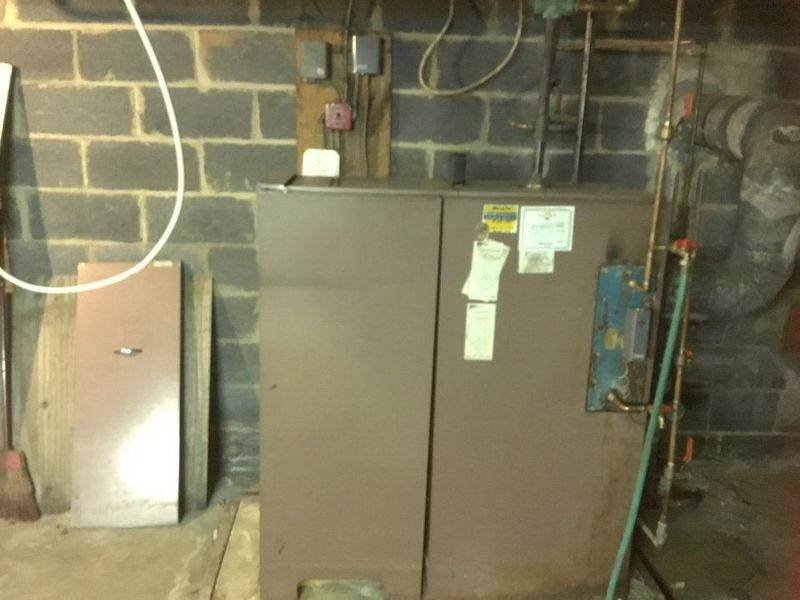

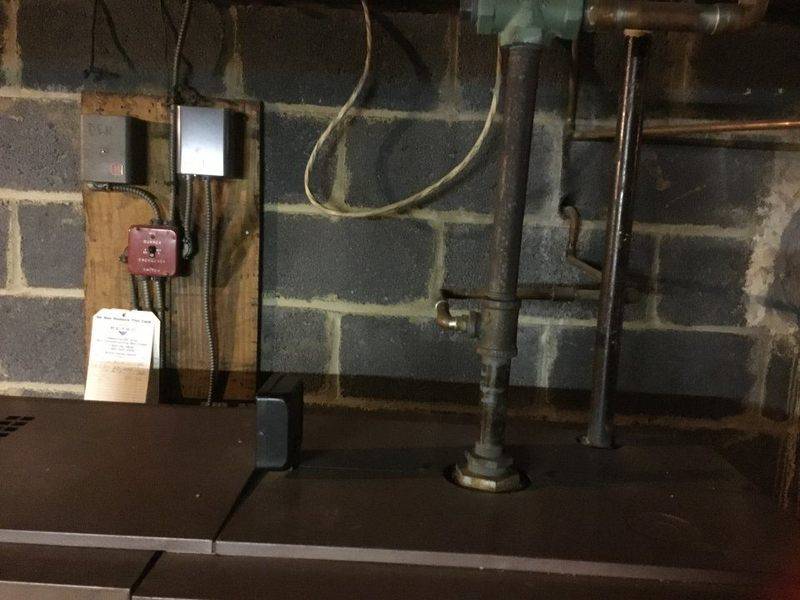

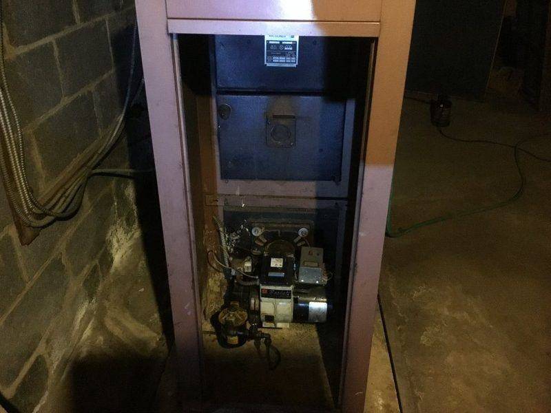

You may take a look at the pictures of my boiler. You may say something about the missing water heater. It may be inside.
