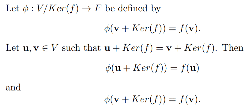

What if you start by defining ##\phi : V/Ker(f) \rightarrow F## by ##\phi(v + Ker(f)) = f(v)##. Can you show that (1) ##\phi## is well defined, (2) ##\phi## is a linear map; (3) ##\phi## is an injection; (4) ##\phi## is a surjection.

I'm not sure that it's true that it's well defined because it's not necessarily true that f(u) = f(v):
If u+ker(f)=v+ker(f) then u-v is in ker(f).
I'm really not sure why this is true.
What does it mean if ##u + ker(f) = v + ker(f)##? It means that ##u## and ##v## are in the same coset of ##ker(f)##. Therefore, ##u \in v + ker(f)##, so there exists some ##k \in ker(f)## such that ##u = v + k##. Thus ##u - v = k \in ker(f)##.

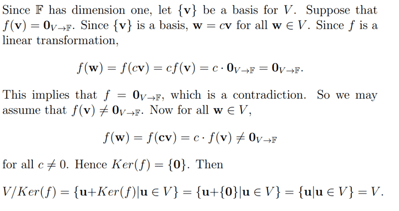

I think I proved it using Dick's ideas!
Since ##\mathbb{F}## has dimension one, let ##\{v\}## be a basis for ##V##.
Nowhere does it say that ##V## has dimension one, so "let ##\{v\}## be a basis for ##V##" is an invalid step. All it says is that you can consider ##\mathbb{F}## as a one-dimensional vector space over itself, but this is always true for any field. They're just saying that so it's clear that they are looking for an isomorphism between vector spaces.
Ohhhh. That's the part I was reading wrong. Now the question makes more sense.
