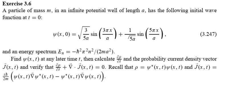

A particle of mass m, in an infinite potential well of length a, has the following initial wave function at t = 0:
probability current density vector and partial time derivative of p
I will include a photo. Essentially, we need to prove that dp/dt + the gradient of J(x,t) = 0.
We are getting that the two are instead equal and opposite, and have checked with multiple people.

Textbook exercise 3.6 on a particle of mass m in an infinite potential well of length a, giving the initial wave function psi(x,0) = sqrt(3/5a) sin(3 pi x / a) + (1/sqrt(5a)) sin(5 pi x / a), equation 3.247, and energy spectrum E_n = -h^2 pi^2 n^2/(2ma^2).
