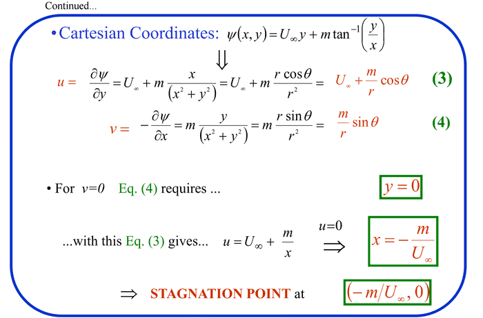

The working out states that v = (m/r)sin(theta) but surely this should be (-m/r)sin(theta) ? I mean there is a negative in front of the ∂Ψ/dx ?
Also, if v=0 then 0 = (m/r)sin(theta), therefore sin(theta) = 0? And from this we know cos(theta) = 1 or -1 which would mean u = Uinfinity + (m/r) or Uinfinity - (m/r) as opposed to u = Uinfinity + (m/x) as they got?

When you take the derivative of ##\arctan (y/x)## with respect to ##x##, you also get a ##-1## factor as ##x## is in the denominator. That cancels the first minus sign.

##x=r\cos \theta##, so ##u=U_\infty +\frac{m}{r}\cos \theta## becomes ##u=U_\infty+\frac{m}{x}## (the ##\cos \theta## cancels out, so it doesn't matter if it is +1 or -1).

I think it has to do with the way the arctan is used here. There are two arguments, x and y, instead of one. There is a special rule for the derivative of tan-1(y/x), as shown in this article:
https://en.wikipedia.org/wiki/Differentiation_rules#Derivatives_of_trigonometric_functions

Oops, the stated reason is wrong.
Actually, ##u=U_\infty +\frac{m}{r}\cos \theta=U_\infty +\frac{m}{x}\cos² \theta##, and as ##\cos \theta =\pm 1##, we get ##u=U_\infty+\frac{m}{x}##.
Sorry for the mistake.
