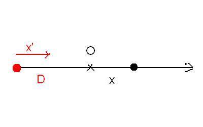

I am unable to understand how the second wave can be written as y2 = A sin(kx-ωt+ø) or in other words how the absence of origin at the source is compensated by a phase constant .
Place the source of the wave in a coordinate system, at distance D to the left from the origin. The distance from the source is x', y=Asin(kx'-ωt).
x' can be expressed by the x coordinate: x'=x+D. Substitute that for x' in the equation of the wave:
y=A sin(k(x+D)-ωt)= Asin(kx-ωt+(Dk)) Dk=θ is the phase constant of the wave in the coordinate system. The wave is advanced by Dk at the origin.

Your explanation is very helpful .Thank you so much :)
