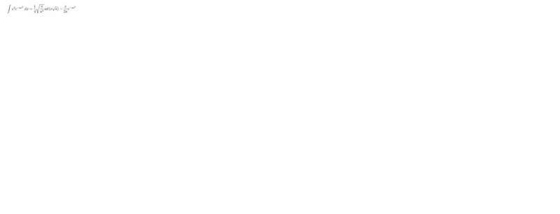

I obtain the integral in the attached photo. Obviously there is a problem evaluating it at +/- ∞ because of the second (subtracted) term, no?
The attachment is illegible for me. Much too small. Did you try integration by parts?

I think you're misunderstanding me. Look here for the integral of interest (the one you're attempting to solve by parts): http://integral-table.com/ and you'll see the "problem" I'm encountering with evaluating the result at +/- infinity.
Number (70)? erf(-∞) = -1, erf(+∞) = +1. The other term vanishes at both extremes, leaving √(π/a)/(2a)
Why does the other term vanish at both extremes? Isn't 0*infinity an indeterminate form?
e-x2 tends to zero much faster than x tends to infinity.
There's an x multiplied by that too however, i.e. xecx2, so at each extreme it becomes +/- infinity * e^-infinity
