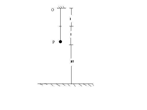

Natural length is "l" and when a "m" mass is hanged on the P edge, it dragged by another "L" length. Point "O" is "4L" far from the floor.

Here's some help for finding the constant c. For reference, let point B be the point at distance L below point O. Between O and B the mass is in free fall. So, you should be able to find the speed of the mass at B as a free-fall problem. After that, the mass is in SHM and the equation with c in it will apply. Think about the value of x at point B. Then apply the formula with c to the point B.
[I see that you already found the speed at B. Sorry.]
Prove that the first two terms in the answer for the time correspond to the time between O and B. From B to the floor the motion is SHM. Try using the equation of motion for SHM (x as a sinusoidal function of time) to find the time when the mass is at B and the time when the mass is at the floor. For the SHM, I would suggest letting t = 0 correspond to the mass passing through x = 0 (the equilibrium point of the SHM).

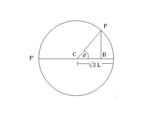

I tried to find the constant "c" by applying the following values.
i. When x = 0 ; v = [itex]\sqrt{3gL}[/itex]
So I'm getting a value of "[itex]\sqrt{3}[/itex]L"​
as "c"
The problem comes when drawing the correspondent circular motion to the SHM. I can see the amplitude is [itex]\sqrt{3}[/itex]L. Can you please draw it for me? I've drawn what I can think of. Is that "2L" distance from point "o" the equilibrium? and can I consider it as the center (as C in the picture) of the circle?

And if I apply "2L" from the point "o" as the equilibrium, I'm getting cos ∂ = √3
That value is making it hard to get the final answer of that time function.
Note that the equilibrium position of the SHM is the point where the mass would hang at rest; namely, at distance 2L below O. Thus, x = 0 corresponds to 2L below O. If you measure x positive downward, then the point located a distance L below O would correspond to x = -L. At distance L below O you have found the velocity to be √(3gL). So, try using this information to find the correct value for c.
Then, you'll need to show that the mass comes to rest at the floor. What does this fact imply for the value of the amplitude of the SHM? What is the value of x at the floor?
Finally, you'll need to use your SHM reference circle to find the time to go from x = -L to the value of x at the floor.
Thanks for the info. I was wrong at calculating "C" then :D I can manage after that. Thanks again!
