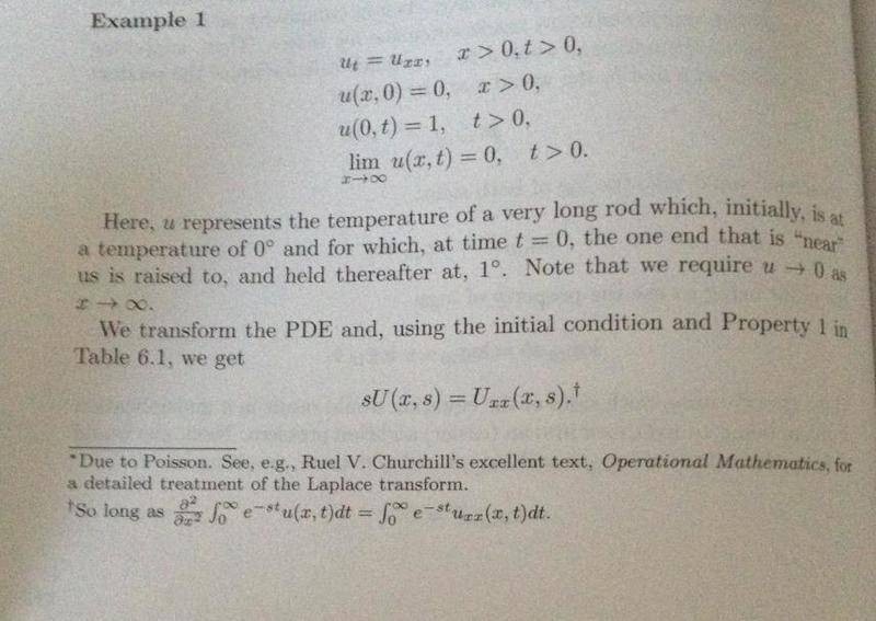

in an example in my text i don't see how they got the "sU" for the transform. actually, i don't even see it in my table of transforms.
Say we have ##y(t)## with ##y(0)= 0##. What is the formula for the transform of the first derivative?
