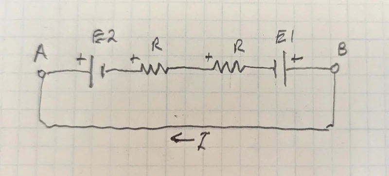

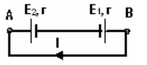

I have a very simple problem with voltages, and I think that the answer in my book is wrong.
In the attached image, what's the voltage between A and B, expressed with E1, E2, I and r?
(The answer in the book is 2Ir + E1 - E2, but I think that is should be -2Ir + E1 - E2).
Thank you!
It looks like ##V_{AB}=0## to me since they are directly connected by a wire.
Is the triangle for ##I## just supposed to represent the direction of the current or is it supposed to be a current source?
Thank you for replying. Of course VAB = 0, but the problem is how to express it using E1, E2, I and r (it's a question from an exam).
My dilemma is if it's 2Ir + E1 - E2, or -2Ir + E1 - E2.
There is no reference about the direction of the current I, just that "the current goes through the wire", I guess it can also be negative.

The arrow must represent a conventional current source, or there could be no potential difference between the points A and B..
The voltage at B wrt A is ##(V_B-V_A) \equiv V_{BA}=E_1-E_2-2IR=0##
The current arrow drawn is an arbitrary polarity definition, so we'll all agree about the signs in the equation. Except your instructor, apparently.
Got it. Thank you!
Perhaps a better schematic would help:
I agree with both you @nickxyzt and @Dale, but consider the wording of the question very confusing – especially for an exam question. It would be clearer to ask for an equation relating E1, E2, r and I.
