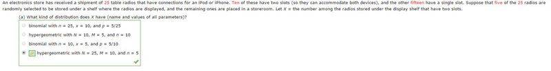

I disagree with this.. I thought that the number of observations is denoted by n, which should equal 15 because we are observing 15 of the projects. M would be the subset, which, since it's asking with regards to the second section, should be 35. So why is M and n flipped in this scenario??
Later in my homework, one of the solutions to the questions even uses a hypergeometric distribution that specifically shows that n=# of observations and m=amount in a subset of N...
Here is a screenshot of said question:
Which question has the wrong "correct" answer then?
Maybe I'm just misinterpreting the questions?
Any help is greatly appreciated! :)
Both book answers are correct.
Have a look at the wiki page on hypergeometrics.
It uses N for population size, K for number of successes in population (M in your course's notation), n for sample size and k for number of successes in sample. k is the variable that we say has a hypergeo distribution.
In your first example N=55, K (M) = 35, n=15, k=10. A paper form the 'second section' is a 'success'.
In your 2nd example N=25, K (M) = 10, n=5. A radio with two slots is a 'success'.

I'm still a bit confused, because for the first scenario, it says n=35 but you're saying n=15 which is what I originally thought
Ah yes, the answer has M and n switched. But their answer of 0.2392 is correct so presumably they didn't have them switched in the calc. My guess is that it's a typing error in that last bit (which I didn't look at) rather than in the calculated probability.

Yeah I got that answer. So to be sure, the second question with the screenshot is the one that has the typo?
No. The first answer has the typo.
Hmm.. okay, I'm still a tad bit confused.. The second problem is the only one that is different from the others.
