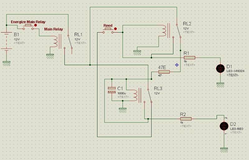

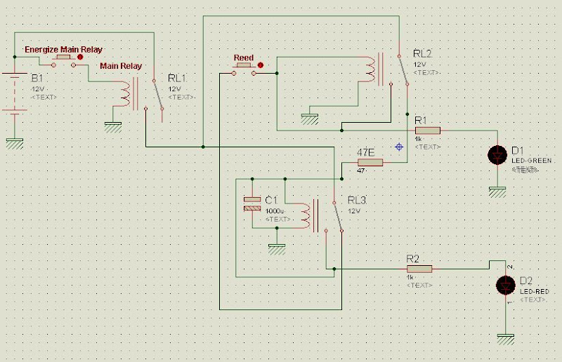

I myself am a big fan of Relay-Relay Logic. So, I took your question as a puzzle, and came up with this no-silicon solution. :)
Schematic of a relay-logic circuit in Proteus style with a 12V battery B1, a Main Relay RL1, a reed switch, relays RL2 and RL3, a 1000u capacitor C1, a 47E resistor, 1k resistors R1 and R2, and LEDs D1 (green) and D2 (red).
See if you can comprehend it and feel free to pop-out question if necessary.
There seems to be one issue. If the Reed Switch is closed when the Main Relay is energized, (Case I), then the Reed switch tend to supply 2.5A required for the Green light. Though, this condition occurs for only brief amount of time, it could damage the reed.
You could place a diode to solve this, but then, it would rip the solution from 'No-silicon' title. :)

the "47E" on your diagram i assumed was a 47 ohm resistor. I tried it with a 47 ohm resistor and the circuit didnt work properly-same problem I was having before, if the reed switch isn't connected at power up, the red light lights up, but if the reed switch closes the green light then latches on until the main relay contacts again open. I tried again with a 10 Ohm resistor since the relays i have have a low resistance (~75Ω), and again with no resistor with the same results. I mabye didnt have this done correctly, but i also prefer the reliability of relay-relay logic-less sensitive to water and voltage variations in my experience.

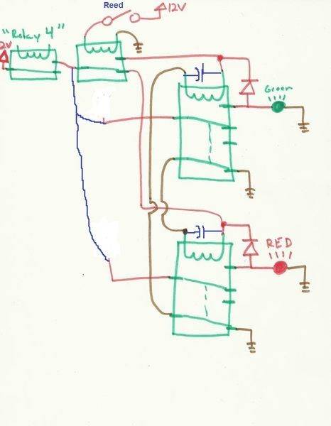

What i am building is basically, a drag racing christmas tree that operates like this one in the first 13 seconds of the video. . The only difference is mine will not have pre stage lights, and for simplicity, let's consider only one side(say all the lights on the left, except pre-stage). The magnet part of the reed switch will go on my snowmobile ski, with the reed switch on a post. When the snowmoile is in place on the start line the reed switch will close and the "Stage" light must be lit. When a button is pressed, the countdown begins, which i have already built with a 555 sending pulses to a 4017 and made functional. Here's where it gets difficult. The 4017 runs 4 relays, that light in the order of the video-yellow, yellow, yellow, but when the 4th relay is energized (the "main" relay I_am_learning has pictured above) the green light must be lit up only if the snowmobile has not moved (reed switch still closed) and stay lit until the reset button is pushed. The reset button de-energizes relay 4. If the snowmobile has moved before the 4th relay is energized, which signals GO to the driver, the driver "jumped" the start (left the line before it was time to go) and i want the red light to light up instead of green, and stay lit until the reset button is pushed. Sorry for the long explanation, just trying to be clear. I did come up with a setup that works, but since i only have SPDT relays, i would need 6 of them which seems redundant-there must be an easier way.
I don't mind using logic gates or or other IC's if that makes things easier.
Thanks again for any help.
  • Hand-drawn relay logic schematic with a 12V supply, a switch and relay labeled "Relay 4", two relay stages driving a green LED and a red LED with flyback diodes, and 12V inputs on the left.

I have simulated the circuit I posted and it did work. But, as you suggested, if you relay has lower resistance, (75Ω), then yes, you might need to use around 10Ω in place of 47ohm.
Also, the please don't ignore the 1000uF capacitor, its a most. The purpose of the resistor and capacitor is to delay the switching of the bottom relay, this delay should be enough to let switch the first top relay first, if the reed switch is on. Also, If you are going to test my circuit, please replace the Reed switch with a Reed+Relay (as you have done in your circuit)

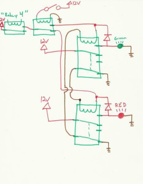

I also checked your circuit, it really looked like it should work. But, don't you want the lights to go off when you deenergize the main relay? If so, you need one little modification, I have shown in the attachment.
But, anyway, I simulated the circuit, and surprisingly it didn't work. I think it has got to do with the diode-turning-on time. When the relay is powered both through direct-line and through diode, it draws all the power from direct-line and the diode is in off state. When you suddenly remove the direct line (by switching some relays), it takes some time to turn on the diode and hence the relay might gets momentarily powered-off,
Although this can be justifiable in simulation where the relays switches instantly, I am finding it hard that it can actually occurs with real circuit.
Anyway, please try adding capacitors (100uf) in parallel with both relays and see if that solves the problem. It solved the problem, atleast in simulation. See the attachment.
  • Hand-drawn relay logic schematic with a reed switch and 12V supply feeding a relay labelled Relay 4, driving two further relays, a green LED and a red LED with diodes.
