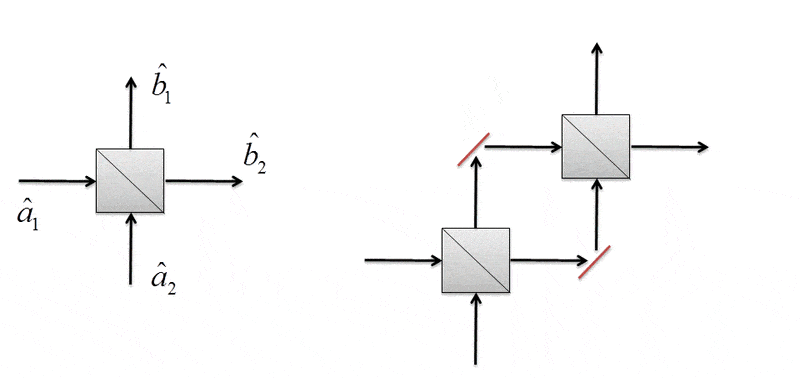

Two photons arrive at a hypothetical 50:50 Beam-Splitter with no phase shift between reflected and transmitted modes. One enters the Left side and the other the Bottom side of the BS as shown in Fig.1 of the link below:
https://drive.google.com/open?id=0B5JsDLKoUSA5emk5Qk9nUHVIelE
Each photon is in one of two possible quantum states, |0> and |1>, characterized by a phase of 0 or 180 degrees, respectively. The two photons leave the BS, emerging from the Top or Right sides, being detected by Photo-Detectors, and having their phases measured by PDTop and PDRight. Assuming that the BS is lossless, the two photons are detected simultaneously by PDTop, PDRight, or each one is detected by a different Photo-Detector at simultaneous time-stamps. With regard to this third scenario, if the two photons are allowed to interfere at the BS, it would seem the quantum state of the photon pair would be a Bell State of form C(|00> + |11>) (Fig.2), or, in other words, due to destructive interference, measuring the phase at the photon arriving at PDTop would tell us what is the measured phase of the photon at PDRight, at any time, no matter the distance between the Photo-Detectors. In this case, the two photons would appear to be entangled. Is it possible to create entangled photon pairs in this way, only by allowing them to interfere? I would very much appreciate your opinions. Thank you very much!

It's late here, I'm tired - so I haven't thought about your proposal a great deal but there are a number of issues here.
1. You want a BS for which we don't get a phase shift between the reflected and transmitted parts? You're not going to be able to preserve the field commutation relations in the output modes in this case, nor are you going to conserve photon number. So that's a non-starter
2. What do you mean by the phase of a single photon? A photon is a number state of the field and doesn't have a well-defined phase - in fact you'll get any value of phase uniformly at random
3. Phase and number are complementary variables (the issues with defining a phase operator notwithstanding) - so you can't measure number and phase just like you can't measure position and momentum

Concerning 3. You mean you cannot prepare number and phase (or position and momentum of a particle) accurately at the same time. You can always measure any quantity as precisely as you like (modulo technical problems in building an accurate measurement device).
Yes - thanks for correcting my sloppiness :sorry:

Hi Simon, thank you! I agree with you entirely, such a BS doesn´t exist. I am new to Quantum Photonics, so forgive my lack of understanding :-). I meant the proposal as a kind of thought experiment, but since came across a very interesting quantum effect related to quantum interference of photon pairs that might work, the Hong–Ou–Mandel Effect. It seems to use the phase difference of 180 degrees between reflected and transmitted modes in a BS to cause a quantum destructive interference. I will try to work out the math and post it here. If I understood your point correctly, though it is possible to define a phase difference between two identical photons, it doesn´t make sense to define phase for individual photons. And, in addition, it is not possible to prepare phase and position of incoming photons due to the uncertainty principle, right? Thanks again.

The basic math you need is quite straightforward - and it's easier to work in the Heisenberg picture to get an input/output relation for the beamsplitter. I'll use ##a## for the input modes and ##b## for the output modes (refer to the figure)
So the input/output relations for the mode annihilation operators are $$ { \hat b }_1 = r {\hat a }_1 + t { \hat a }_2 ~~~~ \rm{and}~~~~{ \hat b }_2 = r {\hat a }_2 + t { \hat a }_1$$The output operators must satisfy the commutation relation ## \left[ \hat b , { \hat b}^\dagger \right] = 1## and also ## \left[ {\hat b}_1 , { \hat b_2}^\dagger \right] = 0## so that the reflection and transmission coefficients obey $$ |r|^2 + |t|^2 = 1 ~~~~ \rm {and} ~~~~ rt^* + tr^* = 0 $$The inverse relations for the annihilation operators are $$ { \hat a }_1 = r^* {\hat b }_1 + t^* { \hat b }_2 ~~~~ \rm{and}~~~~{ \hat a }_2 = r^* {\hat b }_2 + t^* { \hat b }_1$$So if the input state is a single photon state to input mode 1 and vacuum in mode 2 we have $$ | 1, 0 \rangle = { \hat a_1}^\dagger |0,0 \rangle $$The output state is then determined from $$ | 1, 0 \rangle \rightarrow \left( r { \hat b_1 }^\dagger + t { \hat b_2 }^\dagger \right) |0,0 \rangle = r |1,0 \rangle + t | 0,1 \rangle $$where the arrow here is to be read as "the input state becomes the following output state" - so the state to the LHS of the arrow refers to the input modes, and the state on the RHS refers to the output modes.
So now we can use this to generate the output states at a beamsplitter - it can get a bit messy but for inputs like ##|1,0 \rangle## and ##|1,1 \rangle ## and so on, it works nicely with not too much tedious algebra.
Now we have this it's not too difficult (but definitely more tedious) to then work out what happens when we bring those outputs back to interfere at a second beamsplitter, that is the Mach-Zehnder interferometer configuration in the figure above.

Thank you so much Simon! Before I saw your math I had worked out some equations for the Hong-Ou-Mandel Effect. I based myself mainly on Wikipedia, so I am not sure if it is 100% correct, though the general idea seems to agree with your equations. The equations and set-up are here (I haven´t figured out yet how to post nice equations or figures directly ;-)):
https://drive.google.com/open?id=0B5JsDLKoUSA5RWk3dzNGT1g2N05uTjdJYzdWS0d0V3RjUm5z
As you can see in Eq.1, I define the input of two single photons as the input ports' creation operators acting on two vacuum modes. The input creation operators become output creation operators through the BS transformation matrix (Eq. 2 and 3). Finally, due to destructive interference of all cross-over output creation operators (T.R or R.T), Eq. 3 seems to indicate an equal probability of simmultaneous creation of the two photons at output port T or R, and zero probability for the two photons appearing one at each output port separately. The experimental set-up for the effect is in Fig. 2. Since measuring one photon at a TOP detector determines the second photon will appear at the other TOP detector, and never at a RIGHT detector, and vice-versa, even if the detectors are located in different galaxies, they would seem to be entangled. I just can´t figure out the physical meaning of the 1/2 multiplier in Eq. 3. It does seem to indicate equal probabilities for the two outcomes, but wouldn´t 1/square_root(2) make more sense?
Do you spot some mistake in the general idea? Thank you!

Did you get this sorted out Cleber? Sorry I haven't replied more fully. I've had a chance to have a quick look at your working and it seems to me there's a problem with the matrix you're using there. Remember that we have to the correct commutation relations for the output modes and that this gives us a condition on the reflection and transmission coefficients so that ## | r |^2 + |t|^2 = 1## and ##rt^* + tr^* = 0 ##. This implies that you're going to need an ##i## in there in some guise. A typical, and convenient, choice without any essential loss of generality is to set ## r = |r|## and ## t = i |t| ##.
So let's work things out for a 50:50 beamsplitter for which we have the input state ## |1,1 \rangle ##. Keeping the ##r## and ##t## in there for the moment, the input state generates the output state $$ |1,1 \rangle \rightarrow \left( r {\hat b_1}^\dagger + t {\hat b_2}^\dagger \right) \left( r {\hat b_2}^\dagger + t {\hat b_1}^\dagger \right) |0,0 \rangle $$You can see here that the amplitude for the ##|1,1 \rangle## in the output is going to be ##|r|^2 - |t|^2## with our 'typical' choice mentioned above. So for a 50:50 beamsplitter this term is going to vanish and we're going to get both photons in one output arm or the other (upon measurement).
Recalling that ## { \hat a }^\dagger |n \rangle = \sqrt {n+1} ~~ | n+1 \rangle## we then have that the input state ##| 1,1 \rangle ## is going to give us the output state $$ |1,1 \rangle \rightarrow \frac i { \sqrt 2 } \left( |2,0 \rangle + |0,2 \rangle \right) $$for a 50:50 beamsplitter and we can, of course, drop the ##i## here as it's a global phase factor.
It's an entangled state, but it's best not to think of it being an entanglement of 'photons' - rather it's an entanglement of 2 field modes.

Hi Simon, I guess I did sort it out, thanks to the help of the geniuses in here :-) I think I succeeded to work out the math for the HOM effect in Directional Couplers (DCs) as well. DCs are a way to integrate BSs in photonic chips and the main difference is a phase shift of 90 degrees between transmitted and reflected modes. The coupling factor ε can be adjusted by the coupling length between waveguides, and a typical choice is ε = 1/2 for a 50:50 device. Follows the link:
https://drive.google.com/open?id=0B5JsDLKoUSA5TWtIeHdFY2xQRzg
As you can see, here as well the destructive quantum interference that cancels the T.R modes out occurs. But such destructive interference is complete just for ε = 1/2 and identical modes at the input. Do you think a similar effect would be possible for short identical laser pulses at the input instead of single photons? Thank you!
