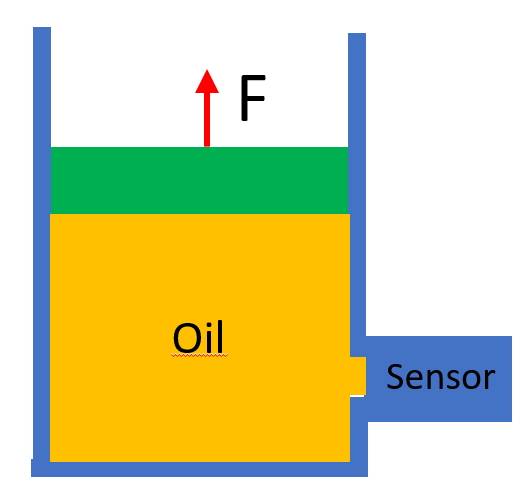

Is it possible to use a liquid oil filled sealed chamber with a movable membrane connected to a pressure sensor to measured the force applied to the membrane?
The reason is have a simpler solution to measured the force.

The "sensor" shown in your figure might have a membrane inside doing just what you described. It depends on the make and model of sensor. There are many ways to do it.
The green part should be a thin movable steel membrane that is connected to a rod and that rod has eg 300N applied force.
The sensor transforms that force to a pressure
That was my idea,
Do you have some example to do this?

What design are you hoping this concept will be "simpler" than? A piezoelectric force sensor is pretty simple considering it has no moving parts and a direct connection to an electrical circuit for logging.
See here: https://en.wikipedia.org/wiki/Piezoelectric_sensor
Ok thanks can it handel force for 300-400N?
Do you know some manufacturers?
There are literally hundreds of options out there because this is a very common measurement need. I'd recommend doing some searching on a product comparison directory like IEEE GlobaSpec for a start, see here: IEEE GlobaSpec Search: Force Sensors.
Omega sells a lot of different sensors, including ones in your operating range. Take a look here: https://www.omega.com/section/load-cells-force-sensors-torque.html
Thank you I will read it
But if I have a constant force at e.g. 300N for couple of minutes < 10 min I thougt the piezoelectric sensors maybe cannot measured that constant load?
You may want to look into piezoresistive based load sensors as well, typically more optimized for DC loads like you mentioned.
