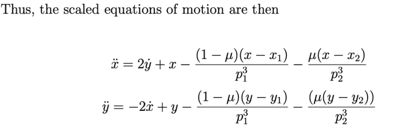

I don't know how to insert the equation of motion of the third body in excel, since it includes vectorrelations as shown in this website: http://www.geom.uiuc.edu/~megraw/MATH1/math1.html

None of those quantities are vectors in the form written. You could re-express the equations as a single vector equation instead of two equations in terms of components if you wanted.
Thanks a lot. How could I do that?
I'm confused. You've got equations in a non-vectorial format. Presumably you've got some kind of differential equation solver going to have been able to solve the two-body problem. I'm not sure I understand what your difficulties are. Why would you need the equations in a vectorial form? I'm not aware of any way to make Excel handle them, unless you've gone pretty deep into VBA.
