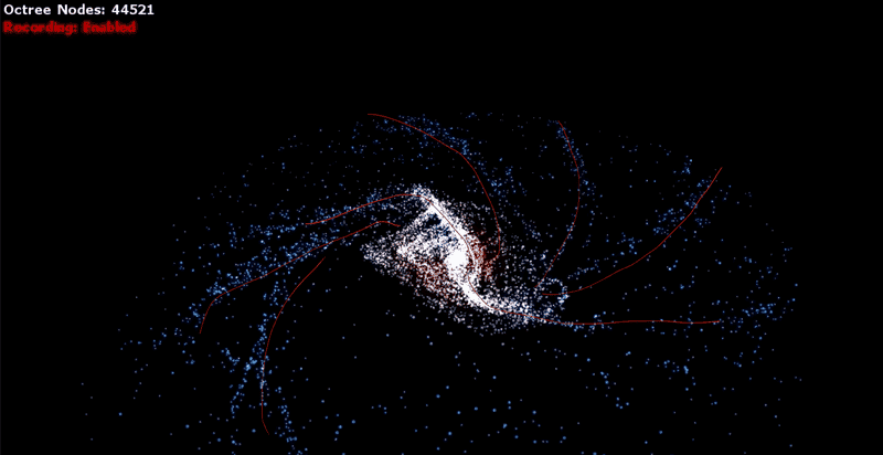

I need help modifying my N-body simulation's force calculation formula so that galaxy simulations give rise to a spiral-arm aesthetic.
Many years ago, for my high school senior project, I wrote a solver for the N-body problem that is performance-optimized using the Barnes-Hut algorithm. (the optimization algorithm is not relevant to my question.)
In one particular simulation, I simulated a spiral galaxy. The simulation is not meant to be scientifically accurate, but is instead meant to demonstrate the simulator. You can view a video of this simulation below:
Now, as you can see in the video, the galaxy develops pseudo-spiral-arms. I say "pseudo" because the arms are not developed according to density wave theory. Instead, I incorporated a trigonometric function, such as sin(), in the gravity-force calculation of the particles. Without this addition, "vanilla" N-body simulations of galaxies do not develop the spiral arm structure you see in the video.
Here are a couple screenshots from the video that show that sin() is being used in the force calculation as evidenced by the wave-like streams of particles annotated by the red lines (note that there are N >2 arms in these screenshots. In the video, if you keep watching, the number of these is reduced and the existing arms grow in size.)
The problem: Now, many years later, I have recovered the source-code of the simulator that is an earlier version of what is used in the video. And in the force calculation of this version of the code, there is no sin() implementation in the force calculation, and thus, I cannot reproduce the spiral-galaxy aesthetic that is seen in the video: the pseudo-spiral-arms do not form.
After many attempts I am unable or recreate the argument that I passed to the sin() function or where I even put it in the force calculation.
Here is the force calculation as derived from Newton's law of gravitation. The smoothing variable is used to prevent singularities from forming and also to prevent wild sling-shot effects:
forceGravity = (G * particleMass1 * particleMass2) / (distanceBetweenParticles^2 + smoothing)
forceGravity is a quantity and I calculate the 3d vector to apply to both of the particle's acceleration vectors according to their relative positions.
So, somewhere in there was a sin() function that gave rise to the aesthetic of spiral arms.
Can anyone figure out/know how to re-implement sin() in the force calculation? I think it was used as a coefficient or something, but I'm unsure what I passed as the parameter to the function. Candidates for variables used in the formula passed as the parameter may include: distance to galactic center, expected galactic radius, something to do with the position of the particles relative to the galactic center, or others that I can't think of.
Any help is greatly appreciated.

If you need more info on how my N-body solver works, it's pretty straightforward if we ignore the optimization algorithm (which we can do because it is not functionally relevant to the physics except during force calculation)
Here is some pseudo-code of the essentials (the actual code is in C#):
Code:
//use this force calculation if two particles are attracting
//use this force calculation if particle is attracting to a tree-node
forceGravity = (G * particleMass1 * nodeMass) / (distanceFromNodeCenterOfGravityToParticle^2 + smoothing)
vec3Gravity = particlePosition1 - particlePosition2
particleNetForce += vec3Gravity.normalize() * forceGravity
particleAcceleration = (particleNetForce / particleMass)

I was just a high school student when I developed this project. The purpose was to create an N-body solver, and then reduce the complexity from O(N^2) to O(nlog(n)) by implementing the Barnes-Hut recursive tree-building optimization algorithm. This was a computer science project that interested me, not a PhD guided research program. I had to present the project to a couple science classes, and thought a reasonably aesthetic visualization would be good.
That is a challenging project for a high school student, and it looks like you executed it well from that point of view.
megapiano said:
These days, I would like to make it more scientifically accurate
Yes, as an adult with that experience behind you you should be aiming higher.
megapiano said:
but I would also like to recover the spiral-arm aesthetic first.
That code uses Euler's method and also adds a constant acceleration to each step, both of which make the method non-conservative. I suggest your first move should be to address this by using a symplectic method and dealing with close approaches in a different way (what is the problem with close approaches anyway: stars being ejected from a galaxy is a real thing? And in 3D close approaches are a very rare event: you are working in 3D?).
The first test of the improved accuracy of your method should be ensuring it maintains a stable 2-body orbit for many rotations.
If you are comfortable in C# then Java would be a step backwards: I cannot see any good reason to go in this direction.

The force calculation is:
d = distance between particle1 and particle2 c = some constant forceGravity = (mass1 * mass2) * (1.0 - sin(min((d * d) / c, 1) * (pi / 2)));
Is anyone familiar with this method? I did not come up with it on my own, I remember adapting it from somewhere, but I can't remember exactly where it came from.
It somewhat resembles Newtons equation: ##f_r = G m_1 m_2 / r^2 ##
where G = 1 and the expression ##(1 - sin ( \theta ) )##
with ##\theta = min ( d^2 / c , 1 ) \pi/2##
so when ##d^2 / c## is between 0 and 1 it is used as the angle factor otherwise 1 is used
the min() insures the angle is between 0 and 90 degrees
and so the ##(1 - sin ( \theta ) )## varies between 0 and 1
Yes, it also seems to make the gravitational field work in a finite distance.
I still cannot find the paper that implemented this specific algorithm.
I also think this method is only appropriate for n-body simulations of specifically galaxies, as it gives rise to spiral-arms and even the bar at the galactic center. I think I may use this method again in more simulations, but also implement a correct galactic rotation curve, which the simulation in the original post does not do.
