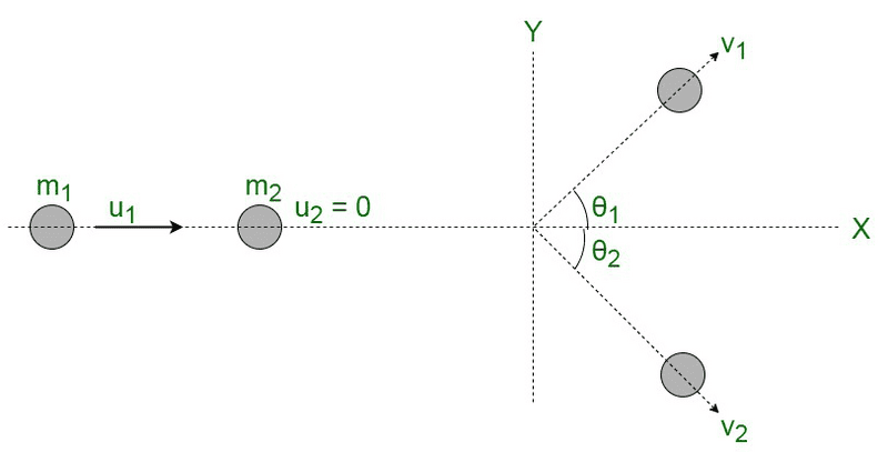

This was my intended approach.
$$m_1u_1=m_1v_1\cos\theta_1 + m_2v_2\cos\theta_2$$$$0=m_1v_1\sin\theta_1 - m_2v_2\sin\theta_2$$$$m_1u^2_1=m_1v^2_1+m_2v^2_2$$
There are two issues here. First, we have four unknowns and only three equations. Second, is this really a 2D problem? I mean, in 2D, can we consider particles to only have head-on collisions even if they have orthogonal velocities?

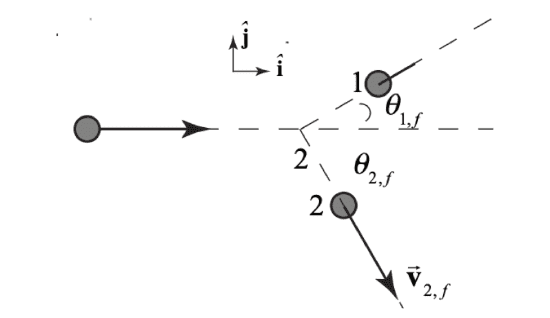

How are they flying off in 2 directions if they are particles without dimension. I could see this scenario as something that could happen with things colliding that have some physical geometry (where a glancing blow is possible), but point masses...I don't get it.
To me, there are three scenarios ##m_1## stops - ##m_2## moves directly to the right, ##m_1## moves to the left - ##m_2## to the right, or they both continue to the right.
To me, there are three scenarios ##m_1## stops, ##m_2## moves directly to the right, ##m_1## moves to the left, ##m_2## to the left, and they both continue to the right.
Third problem. Perhaps I should visit my professor's office tomorrow to discuss these issues with him.

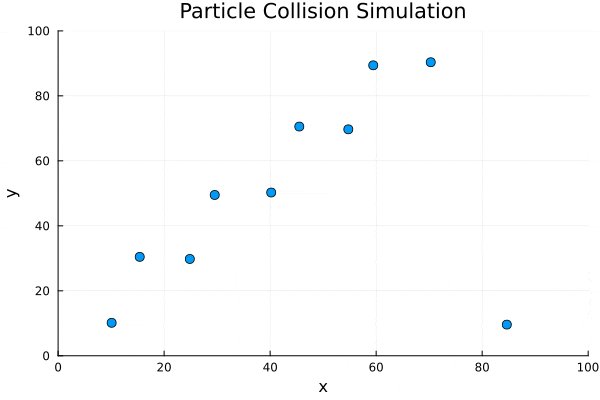

That's exactly what I did for my first simulation with just two disks. It's an effective method, but it doesn't work for disks with high speed because the position intervals become too large, causing the code to miss collisions. Reducing the time step (dt) to a very small value introduces its own problems.
Thank you, @kuruman, @Steve4Physics, and @erobz, for your time. I'll discuss this with him tomorrow. I hope this issue will be resolved with my professor's assistance tomorrow. However, if any problems persist regarding the physics of the problem, I will reach out again.

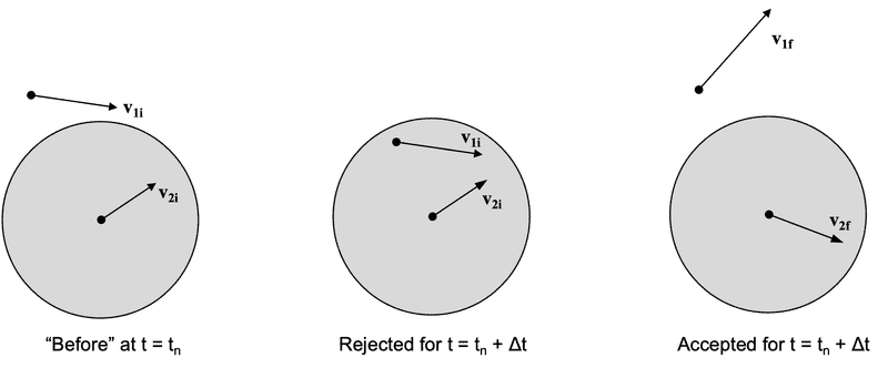

You can do what you want because it's your simulation. If I were simulating this, I would use the following piece of flowchart that requires only the 1-d equations linking the final velocity components to the initial velocity components.
Start with initial positions ##\mathbf r_{1i},~\mathbf r_{2i}## and velocities ##\mathbf v_{1i},~\mathbf v_{2i}.##
Calculate the tentative final positions using ##\mathbf r_{1f}= \mathbf r_{1i}+\mathbf v_{1i}\Delta t## and ##\mathbf r_{2f}= \mathbf r_{1i}+\mathbf v_{2i}\Delta t##.
If the tentative final positions do not imply a collision, then they become the actual final positions in which case the become the initial positions and you go back to step 1.
If the tentative final positions imply a collision, then the initial positions are kept, and you go back to step 1 with ##\mathbf v_{1f},~\mathbf v_{2f}## becoming ##\mathbf v_{1i},~\mathbf v_{2i}.## I show below how to get these.
A unit vector parallel to the center-to-center direction from mass 1 towards mass 2 is, in terms of the Cartesian axes that you have adopted, $$ \mathbf{\hat n}_{\parallel} =\frac{\mathbf r_{2}-\mathbf r_{1}}{|\mathbf r_{2}-\mathbf r_{1}|} =\frac{ (x_2-x_1)~\mathbf {\hat x}+ (y_2-y_1)~\mathbf {\hat y} } {\left[(x_2-x_1)^2+ (y_2-y_1)^2 \right]^{1/2}}$$ Once you have the parallel unit vector, the perpendicular unit vector can be written as $$\mathbf{\hat n}_{\perp}=\frac{ (y_2-y_1)~\mathbf {\hat x}- (x_2-x_1)~\mathbf {\hat y} } {\left[(x_2-x_1)^2+ (y_2-y_1)^2 \right]^{1/2}}.$$ The velocities before the collision have components in the parallel and perpendicular directions given by, $$ v_{k,\parallel}^{\text{before}} = \mathbf{v}_k^{\text{before}}\cdot\mathbf{\hat n}_{\parallel}~; ~~
v_{k,\perp}^{\text{before}} = \mathbf{v}_k^{\text{before}}\cdot\mathbf{\hat n}_{\perp}~~~~(k=1,2).
$$After the collision, the perpendicular components are the same as before. The parallel components are related to the "before" components as given in the reference in post #2.
What we have done here is calculate the final velocities in a rotated frame where one has a 1d collision along the center-to-center distance which is the direction along which the momentum transfer takes place.
What if the overlap of the discs is only for part of the way between the two positions? Are you assuming ##\Delta t## is so small we can ignore such glancing blows?
… except that there are all the other possible collisions these two particles might have before that. Having thought about it some more, I think the approach I described in post #14 avoids some pitfalls. Given that a video is to be generated, I would:

MatinSAR said:
Another challenge I encountered is that I considered velocity changes only along the line connecting the moving and stationary particles during a collision. However, in many references, I see that velocity changes occur in two directions.
https://phys.libretexts.org/Bookshelves/Classical_Mechanics/Classical_Mechanics_(Dourmashkin)/15:_Collision_Theory/15.06:_Two_Dimensional_Elastic_Collisions
Yes, you need to treat the collisions as oblique.
In using the equations at that link, there are ambiguities you need to resolve: square root signs and arctan values. Do you understand how to do that?
