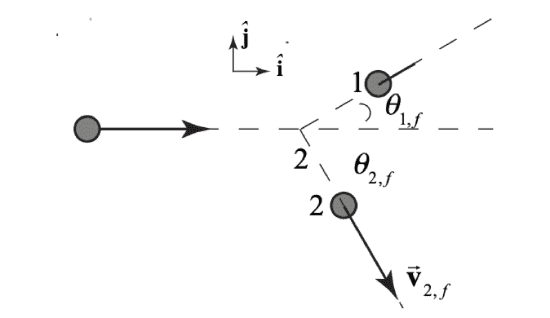

I'm having trouble understanding how to use those equations to determine the four unknowns (two angles and two speeds). IMO we need to measure at least one angle in the lab to be able to calculate the magnitudes of the velocities after the collision.
For example, the equation above don't provide any information about the velocities post-collision because we don't know the angles ##\theta_{1,f}## and ##\theta_{2,f}## and we do not know ##v_{1,f}##.
Edit: By reviewing the equations in post #4, I am now 90% sure that I cannot use the equations from that link-15.6: Two Dimensional Elastic Collisions- in my code...
We need to measure one of the angles in the lab frame. Don't you agree, @haruspex?

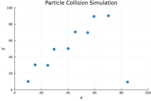

This is what I did except that I did not use relative velocity.
Code:
function update_velocities!(vx1, vy1, vx2, vy2, x1, y1, x2, y2, r1, r2, m1, m2)
    # Relative position
    Δx = x2 - x1
    Δy = y2 - y1
    distance = sqrt(Δx^2 + Δy^2)
    # Normal vector (unit vector from particle 1 to 2)
    nx = Δx / distance
    ny = Δy / distance
    # Tangent vector (perpendicular to the normal vector)
    tx = -ny
    ty = nx
    # Dot products with normal vector
    vn1 = vx1 * nx + vy1 * ny
    vn2 = vx2 * nx + vy2 * ny
    # Dot products with tangent vector (remain unchanged)
    vt1 = vx1 * tx + vy1 * ty
    vt2 = vx2 * tx + vy2 * ty
    # Update normal components based on elastic collision principles
    new_vn1 = (vn1 * (m1 - m2) + 2 * m2 * vn2) / (m1 + m2)
    new_vn2 = (vn2 * (m2 - m1) + 2 * m1 * vn1) / (m1 + m2)
    # Update velocities
    vx1_new = tx * vt1 + nx * new_vn1
    vy1_new = ty * vt1 + ny * new_vn1
    vx2_new = tx * vt2 + nx * new_vn2
    vy2_new = ty * vt2 + ny * new_vn2
    return vx1_new, vy1_new, vx2_new, vy2_new
end
I wanted to consider a situation where the velocity changes in both directions, even perpendicular to the line connecting the centers of mass of two objects.
But as I mentioned in post #34, I regret it, and it's a waste of time in my opinion.
There is no such situation. On what basis would you decide those velocity changes?
I believe the diagram you posted is merely a simplified version, not showing the line of centres at impact (which must have been parallel to ##v_{2,f}##).
See the diagrams at https://www.physicsforums.com/threads/how-does-elastic-collision-angle-relate-to-mass-ratios.983227/.
Output of my work as a GIF: (this is the 1st version)
I believed that, in general, the force exerted on particle 2 by particle 1 is not aligned with the line connecting their centers. But it is, yes?
It seems I misunderstood this concept. I'll need to go over the chapter on collisions again, more carefully.
In the idealisation of uniform spheres, no friction, it will be aligned with the line of centres.
