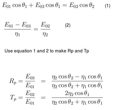

Question is in the attachment, this is for revision not homework

That was nasty. Lots of algebra and you'll have to use some long division. Try playing around with the formulas a bit.
Do you have the workings?
I did work out the problem, but I can't really help you unless you show some of your own work, so I just gave some hints about what to do. Try finding T by using (2) to find
E_{03}=E_{01}-\frac{\eta_{1}E_{02}}{\eta_{2}}
Then plug it into (1) and you should get the result easily. Solving for R is trickier, but I gave a good hint.
I would put my working but I am slow in writing latex and my exam is tomorrow, thanks for the help anyway
It's a lot easier than it looks, treat everything like a constant except the Es
E_{1} c_1 + E_3 c_1 - E_2 c_2 = 0
\eta _2 E_1 - \eta _2 E_3 + \eta _1 E_2 = 0
Add \frac{c_1}{\eta_2} of equation 2 to equation 1 to get you started? Solve for Es.
